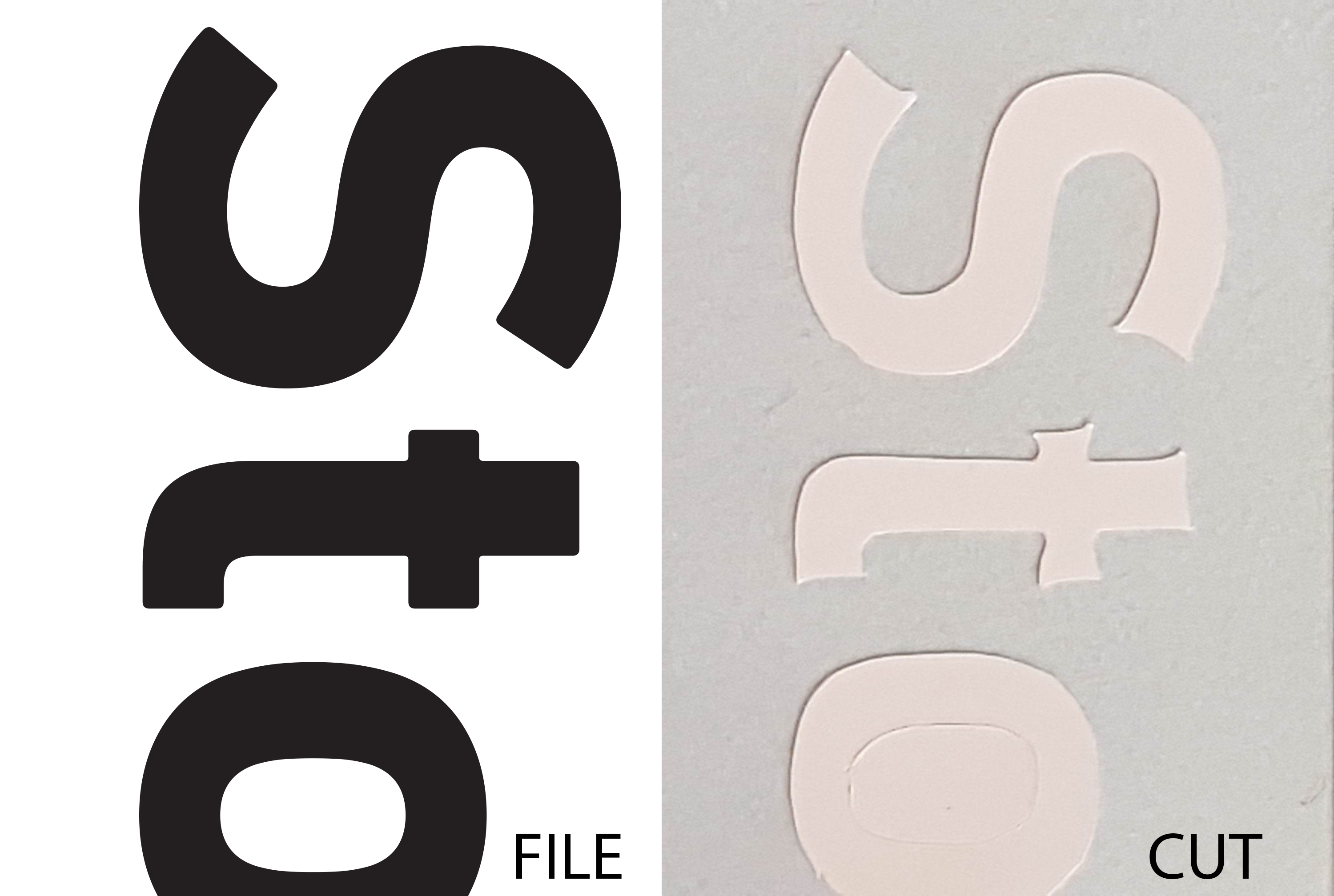

I am running with new blades and a new blade holder but I am now just getting funky cuts so it may be the cutting strip or a bad motor I honestly don't know
