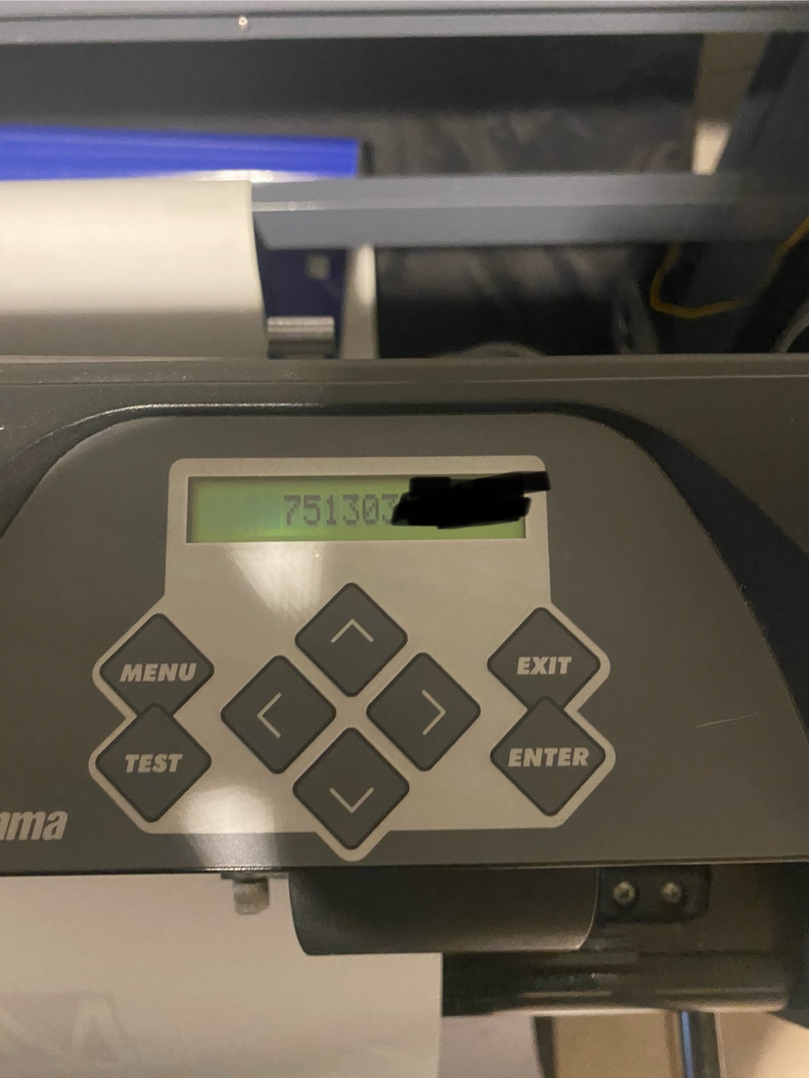

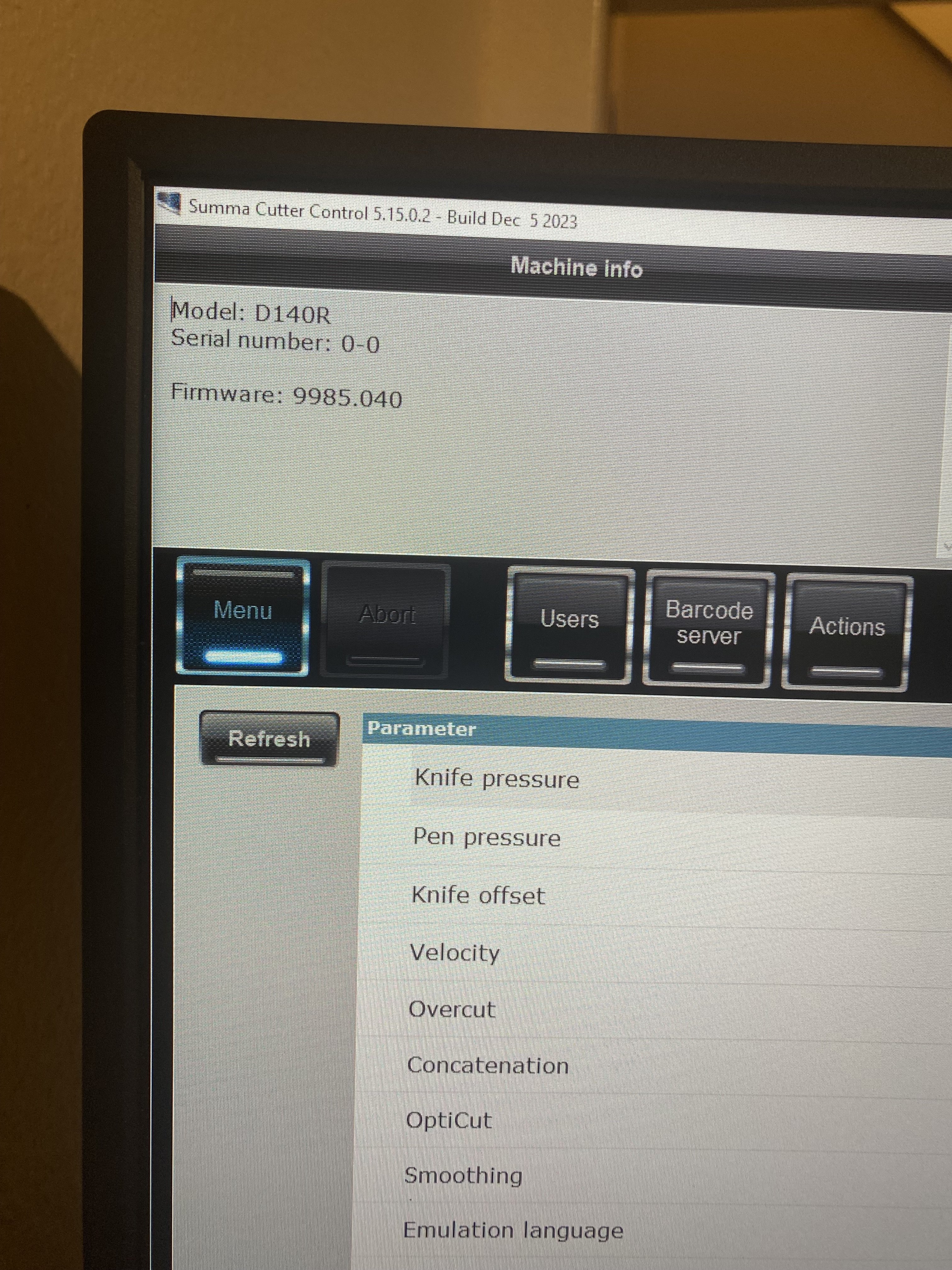

I did everything I can my OPOS was reading alittle and miss cutting I did all the trouble shooting before I update.so I update to the newest firmware M9985-.040 now my serial number is not listed on the fw version and not on cutter control. Can anybody help with this I think my machine not having serial number listed is the reason my opos

cornholio
Looks like your parameters got lost. You can get the factory backup from summa.com and restore them on your unit.
tomcnc
Got that done the serial number now my OPOS not reading just doing circle around black box

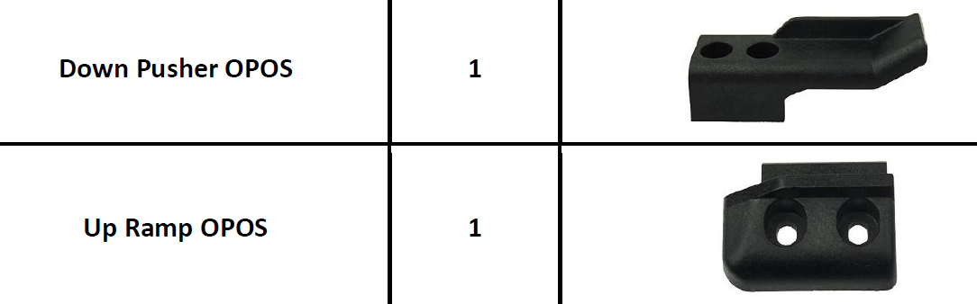

Attila Nagy
Cannot see clearly on the video, I could be wrong, but seems like the sensor did not drop. still in up position. Cannot hear the drop neither when carriage stops at the left.

Attila Nagy
There is only one that’s on right side
The right one pushes it back up.
Someone hoped, that way can be use wider material if it was removed.
The opos needs to be down for the accurate reading.
Nothing to do with the firmware upgrade, but the mechanical Downgrade.
