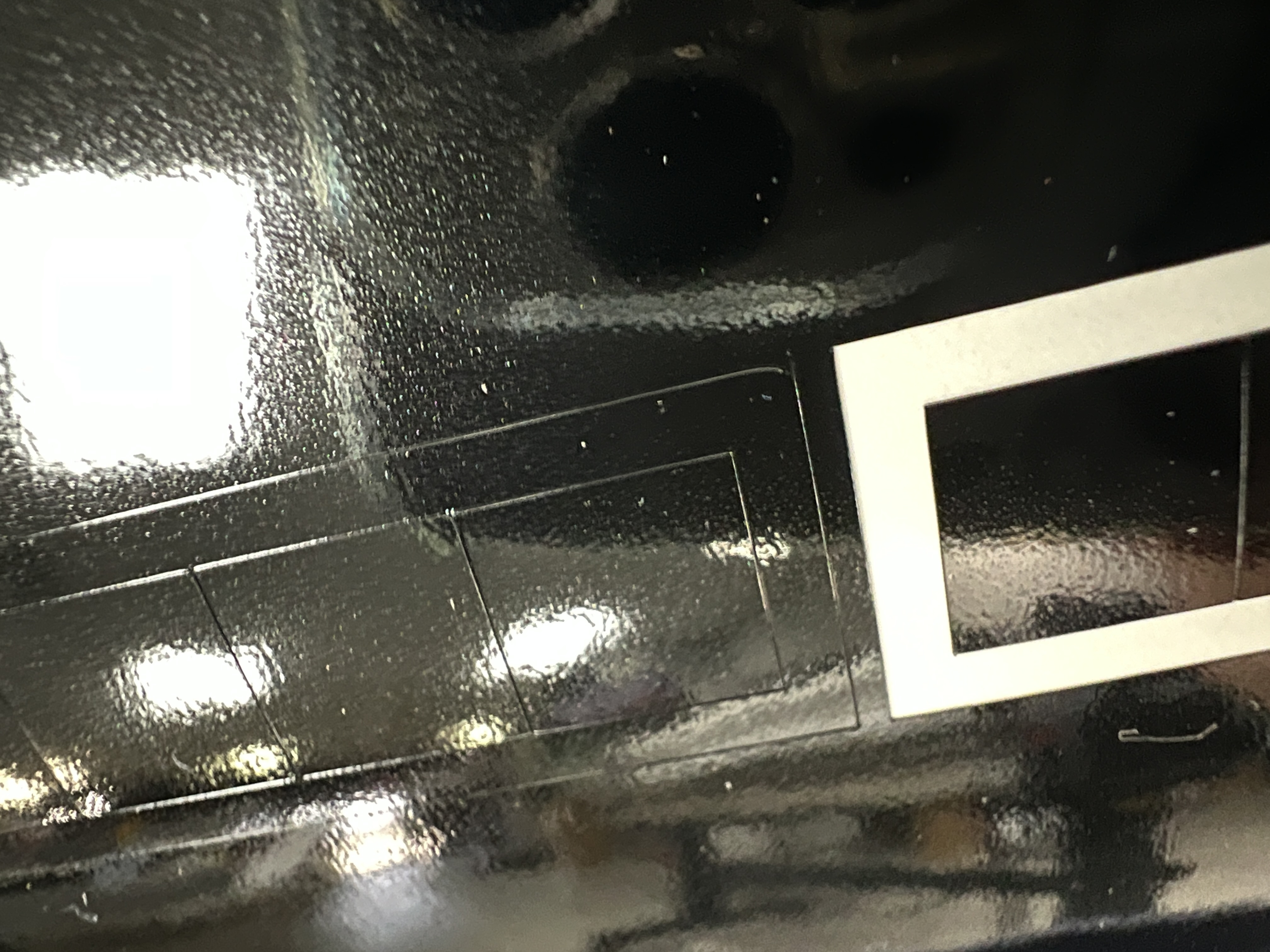

I'm getting a gap at the start of a cut (top right of pic, in unweeded offset test cut). Also having issues with gaps in curves like O's.
I'm not having issues with digital media with reg marks, only colored vinyl. I've been through all the settings: offset is good, overcut makes no difference to the gap, neither does smoothing, down acceleration, or sorting. Does the same thing with new or old blades. Blade holder's clean, but maybe it needs to be replaced? I know there's teeny ball bearings in it for the drag knife but it's not anything I've seen before. It seems as though the blade isn't in the correct direction when the cut starts and takes a mm or so to get turned around.
Any input would be super!!!

Over cut or blade offset may need adjusted. look at your manual or look for the online manual. They cover what a proper looking test cut looks like & how to adjust.
cornholio
is
it only at the first cut? Then it could be the damper inside the solenoid being compressed. This is a known problem in older Summas. The official solution is to replace the cutting head. I refurbished a couple of these heads successfully with new dampers.

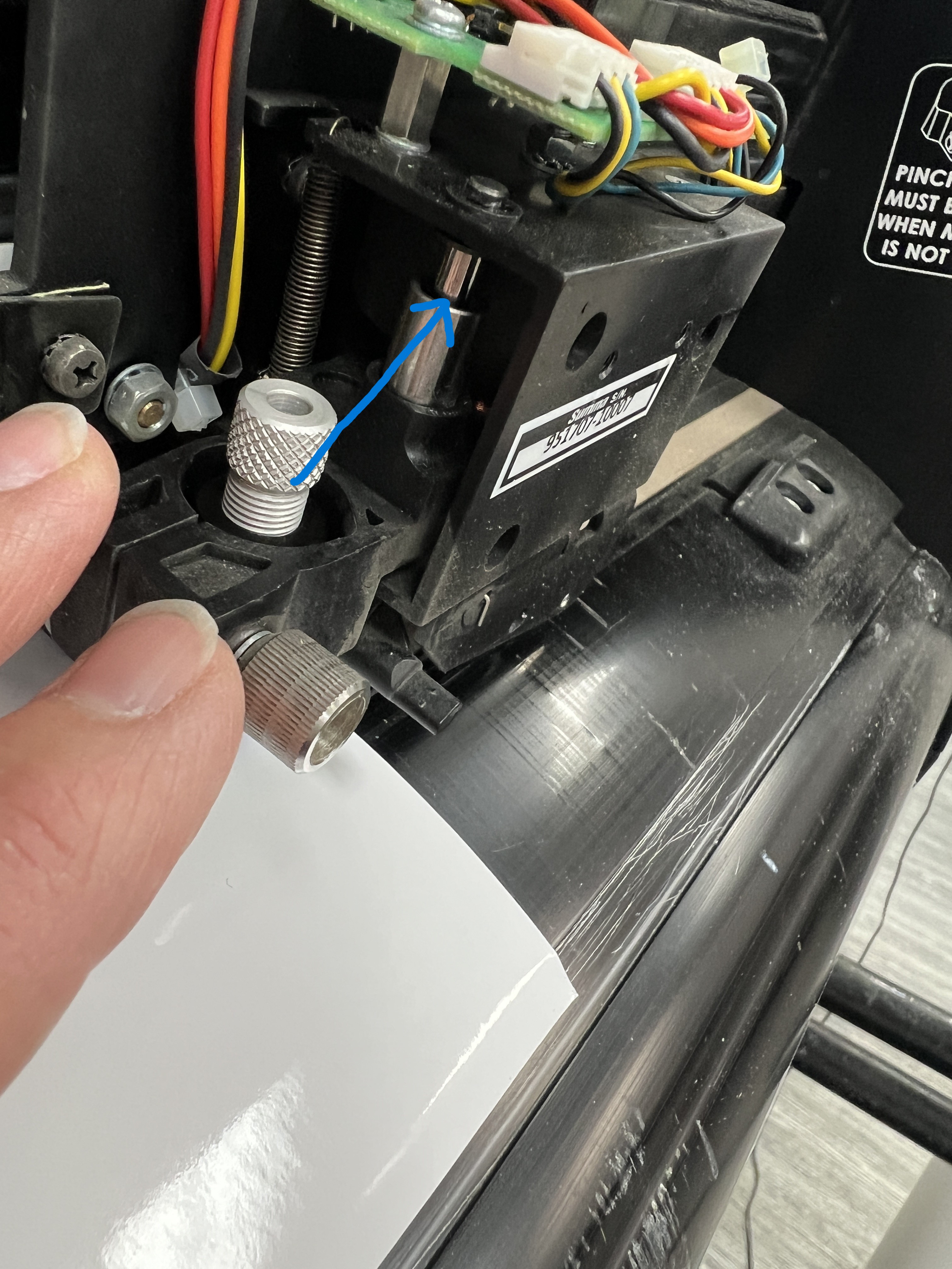

Thanks so much!!! I took off the cover and put a tiny drop of lubricant here:
And that seemed to do the trick! I may have to change or refurbish the cutting head but that's future me's problem lol
