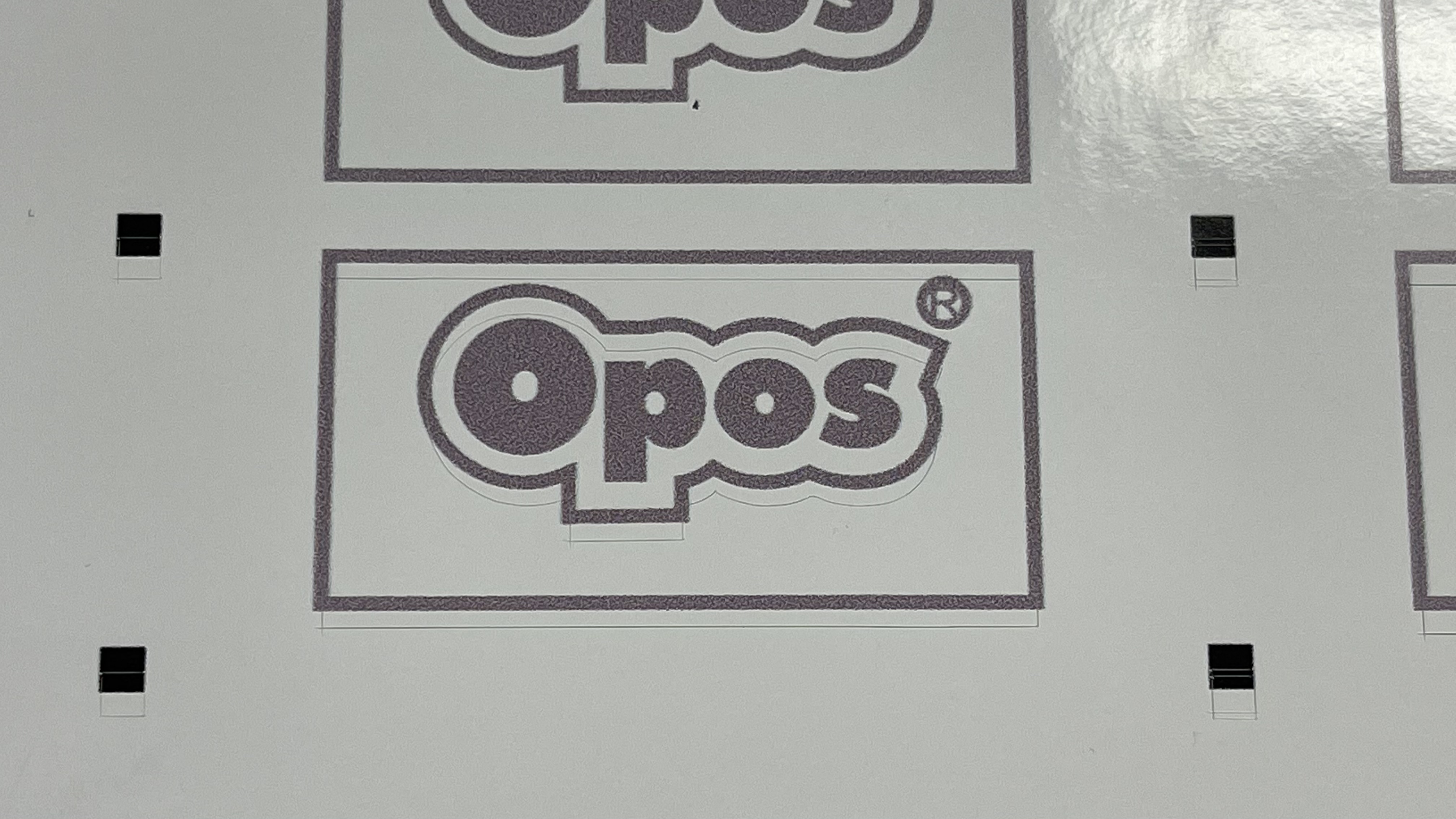

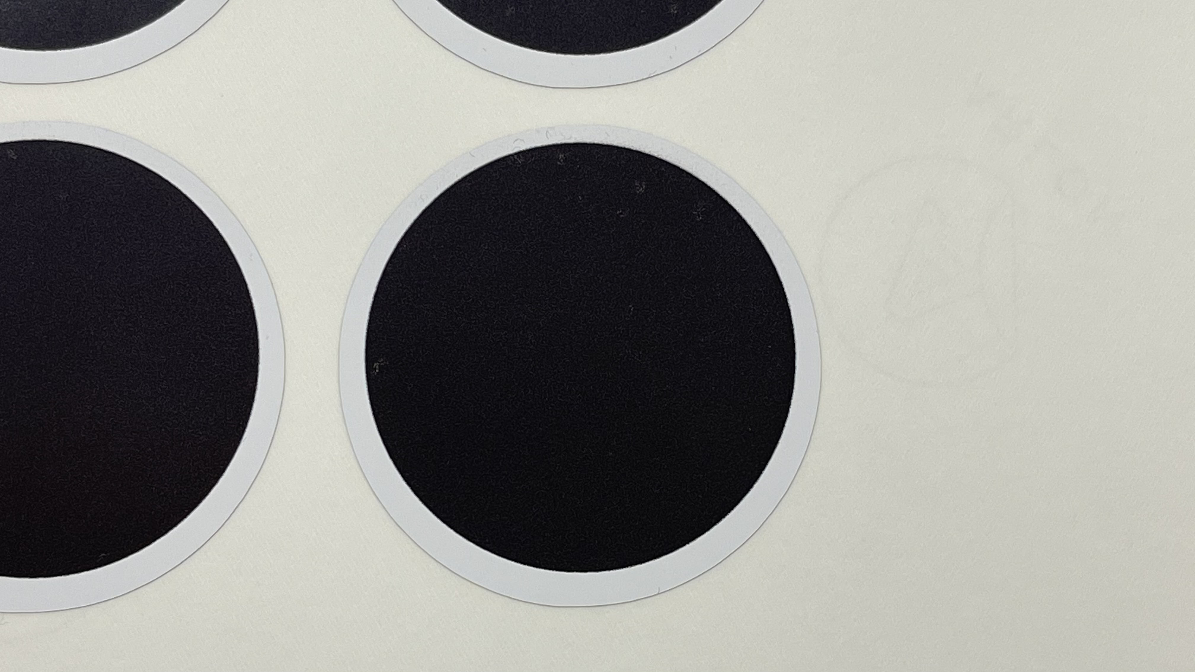

Im having this issue, need to print 50mm diameter circles and the cut line is way off.
Is there a way to calibrate this?
Im using an HP360. Vinyl is not laminated.
Run the OPOS Calibration. It is best to run this using a 20+ inch square of black cutter vinyl with white paper release liner (ideally not white SAV printed black). The procedure should be in your user manual for the cutter.
