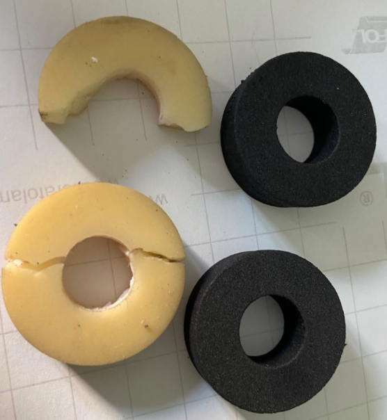

Hi,

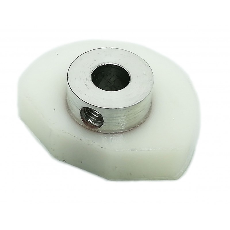

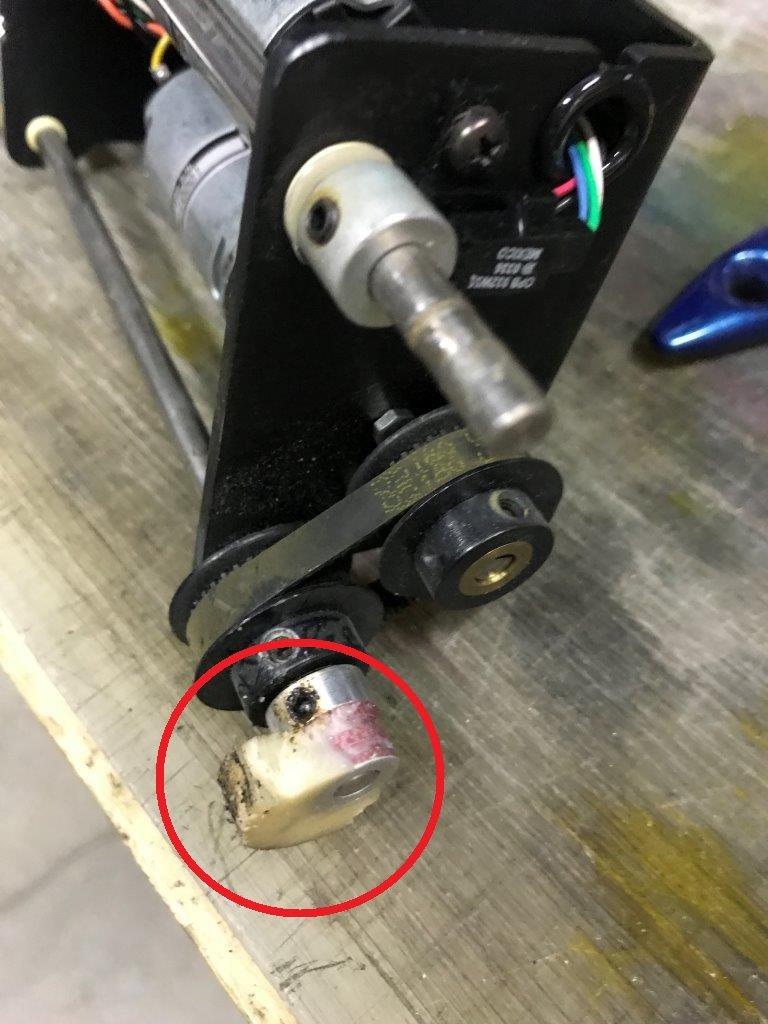

the CASSETTE CHANGE WHEEL disintegrated, I contacted a company that only sells the whole set, it costs 650€, they do not sell just the wheel, I am very disappointed with Summa, it was a bad purchase, I managed to resolve the matter with a bit I made a cut with a CO2 laser, the size of the circle is 30.5mm, the inside is 10mm, and I glued it with glue "cola prego", it works beautifully
I sincerely hope I could help someone
Kind regards

mpsinformatica

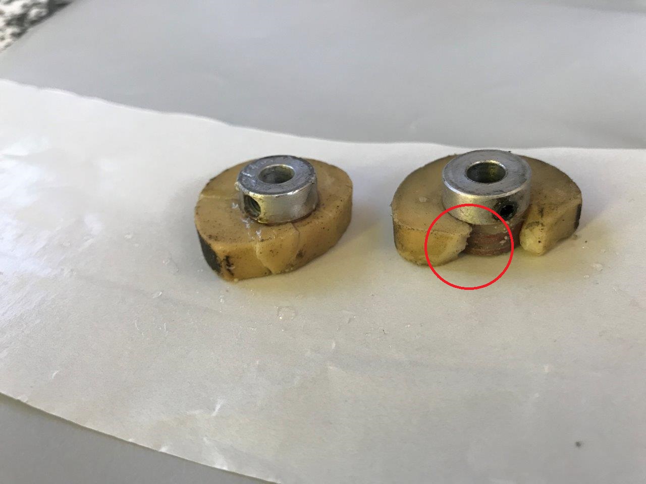

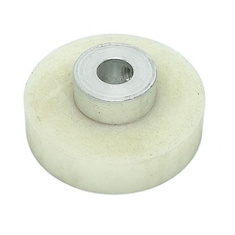

They broke for me too and now I have to change them, but they cost a lot. If you have noticed, two are complete round (code 420-025 price 70 Euro/each) and two are beveled (code 420-024 price 155 Euro/each).

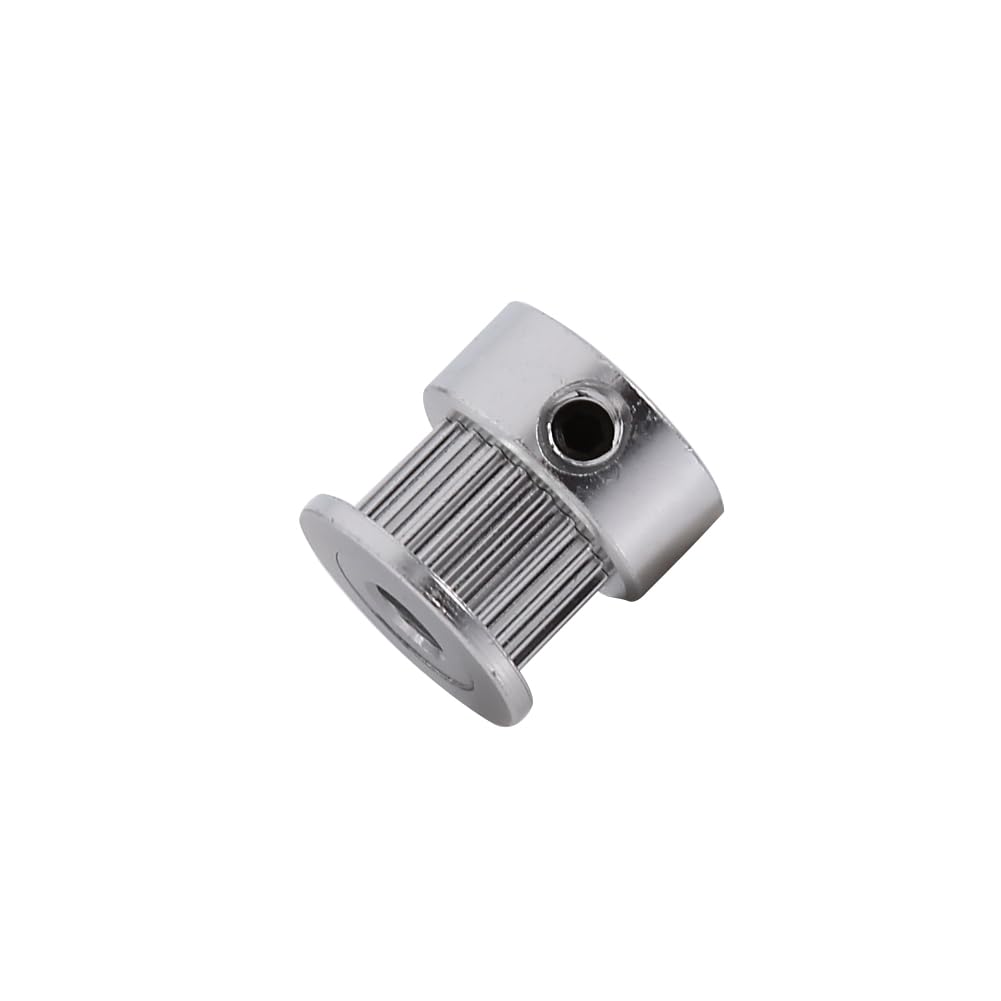

So I wanted to have them rebuilt by a company that produces rubber. There will be a problem for the two wheels with the chamfer, I also have the problem of the pulleys, as 2 have been completely ruined as the grain is destroyed.
Now I have found some pulleys to re-tire like the ones in the photo as an alternative to the one with the longitudinal grooves as in the photo with the circle.

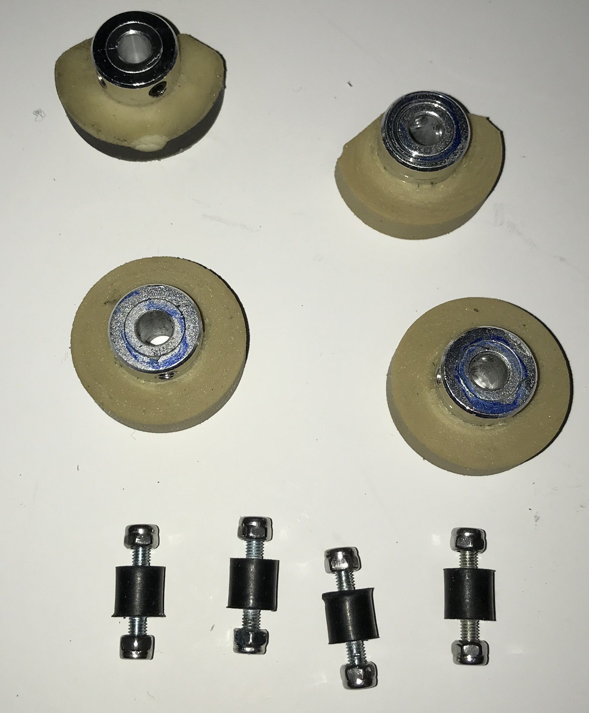

I can finally send photos of my new silent block wheel and suspension kit for my DC3. For those who need it they have been completely redone. Complete kit price 250 Euro
The one on the top left is still the old one. ;)
