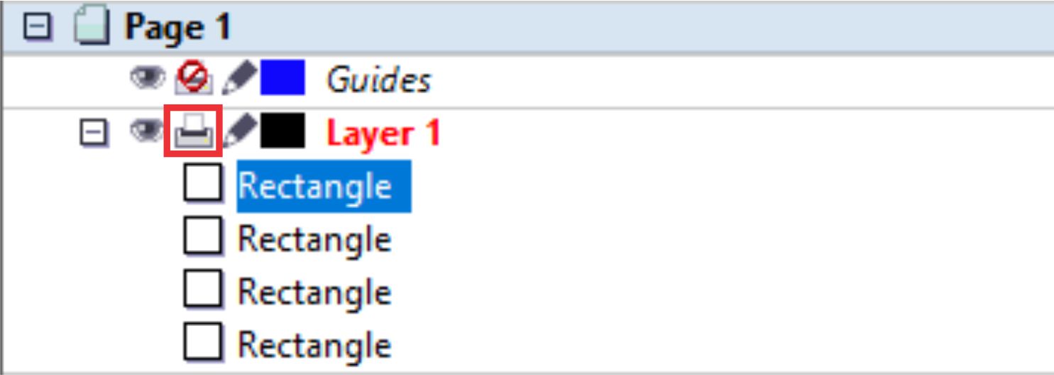

Ok, getting this beast ready to rock. Coming from a strictly cut only background, print it new to me. I have my design work done in Coreldraw and I have to colorcontrol plug-in installed. I click it, it opens colorcontrol but nothing is there but the blue color control background. I’m sending as eps3
help a fella out
Little late, so you probably have this figured out, but make sure that all the objects are on a layer that has Printing and Exporting enabled in the Object Manager panel.
The attached screenshot is from X6, in DRAW 2019 it's kind of hidden. You have to over your mouse over the layer in the Objects panel to have the buttons show up.
