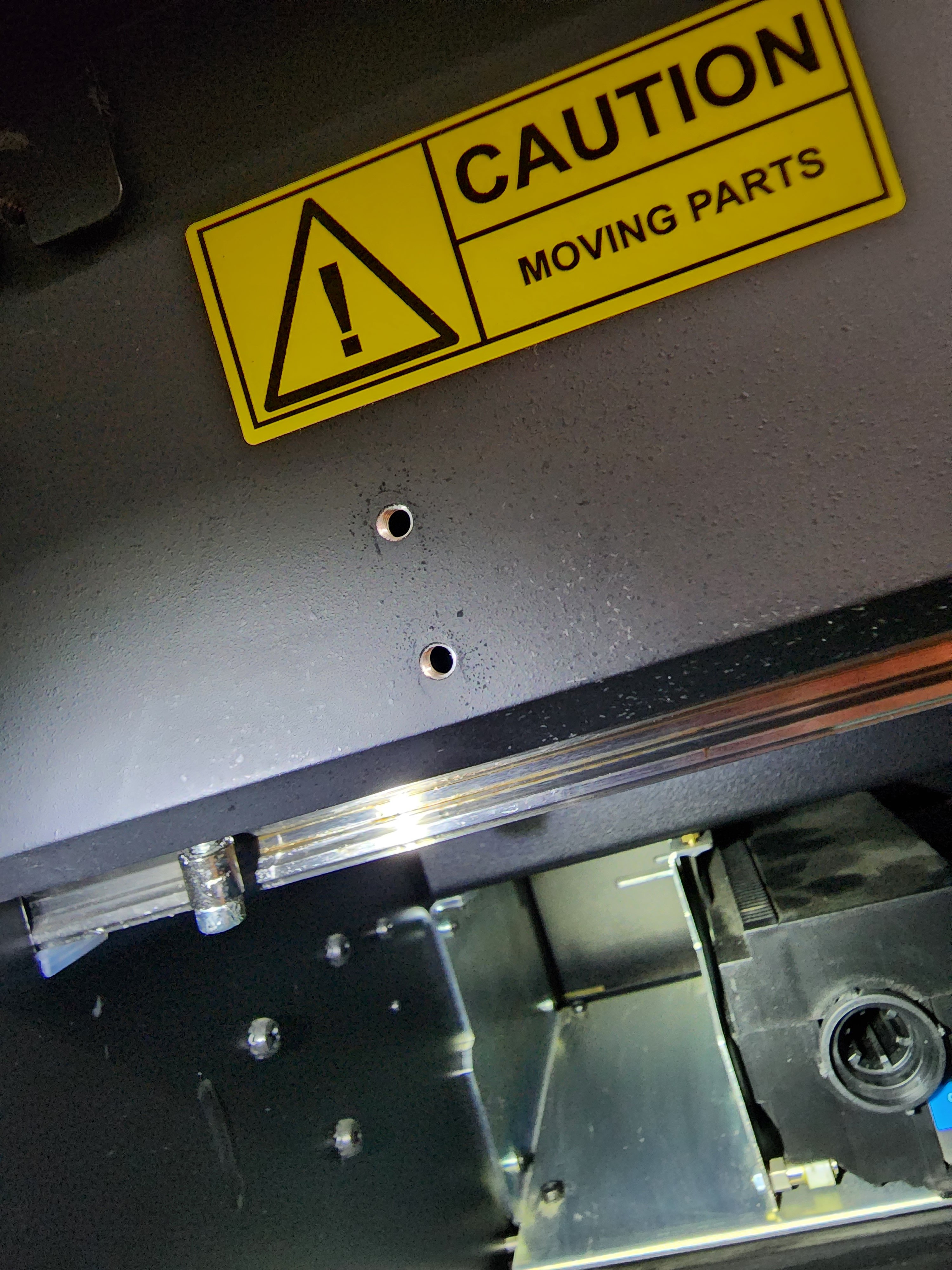

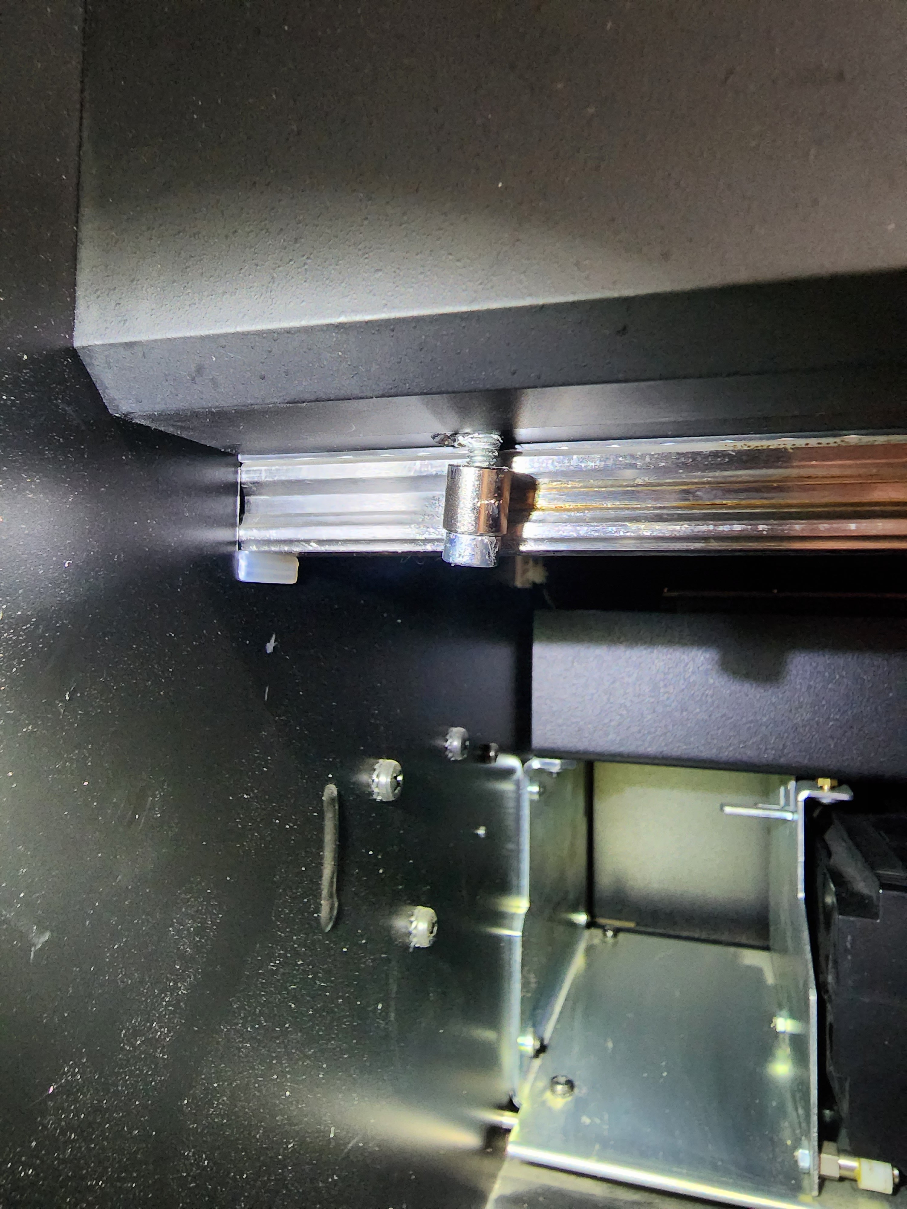

Alright guys, I found one or maybe two issues wrapped into one. Is there any summa experts here ? I think my fatal drum error is from possibly not having a limit switch. One image shows a bolt with a sleeve on that the print head was slamming into around the home position. Next image looke like an area where a limit switch should be mounted. Does this make sense or can someone tag a summa guru? 20230128_200910.jpg 20230128_200915.jpg
