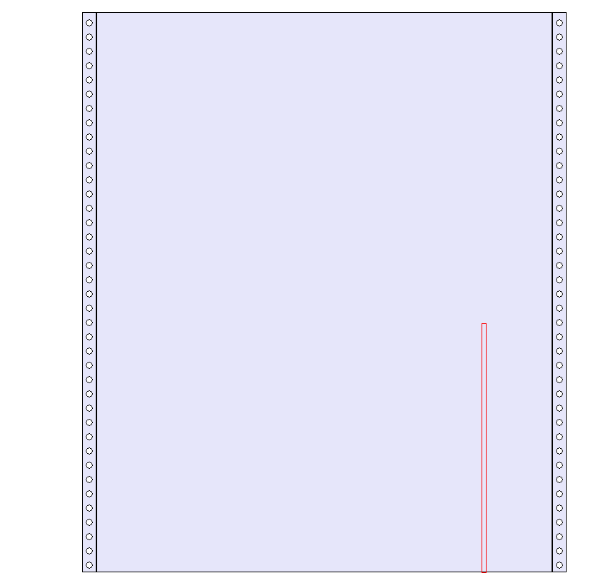

The preview doesn't even show the segmentation. There used to be a line showing the break, and we could adjust it (to put it between letters instead of cutting through one, for example). I'm just testing a long rectangle, but it is 5ft long, long enough to panel. There is no line, and it only cuts the front section of the shape, feeds it as if it were going to cut the back section, then stops.
