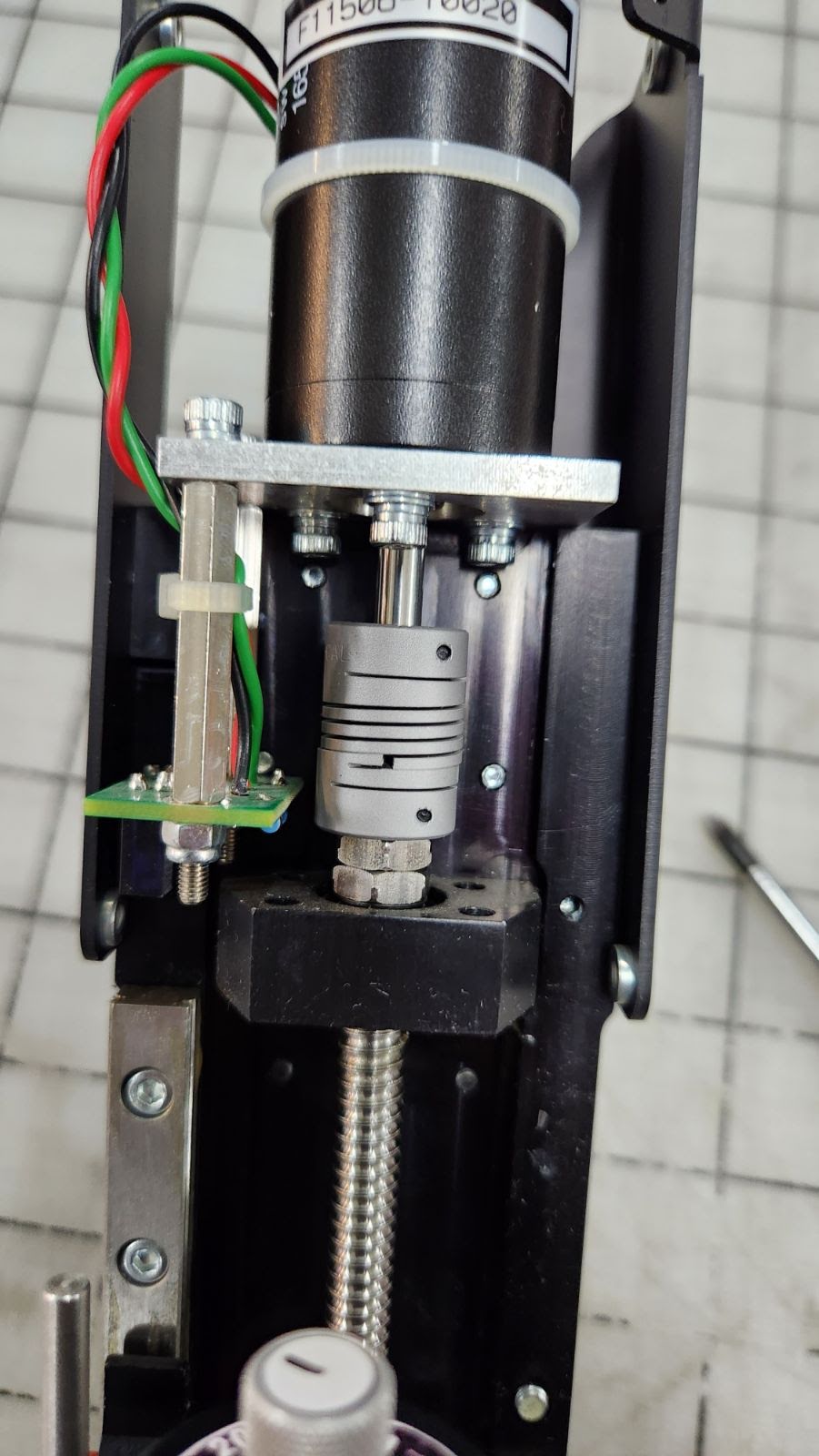

Hi, I am looking for this part on the tangential module. Its on the up/down axis. Thanks!

To me it looks like the shaft coupler is broken.
Measure the shaft sizes and size of the coupler and go to:
You do need to find why it broke, maybe misalignment, a seized bearing or something else is/was stuck.

I bought the part through Airmark. I called and described the part and the sales person patched me through to a tech who immediately knew what it was. The part is a HeliCal WAC15. I installed it in about 15 mins. It's working great again.
thanks! I found a local company that sells them. I think it snapped because my guys were using the kiss cutting tool to cut polystyrene material instead of the single edge blade tool... I re-lubed all moving metal parts but if it breaks again then I will check out if anything looks seized.

That coupler is designed specifically to flex some and or fail in order to prevent much more expensive parts from being damaged in the event of an overload. Probably a good part to keep a spare of on hand.
