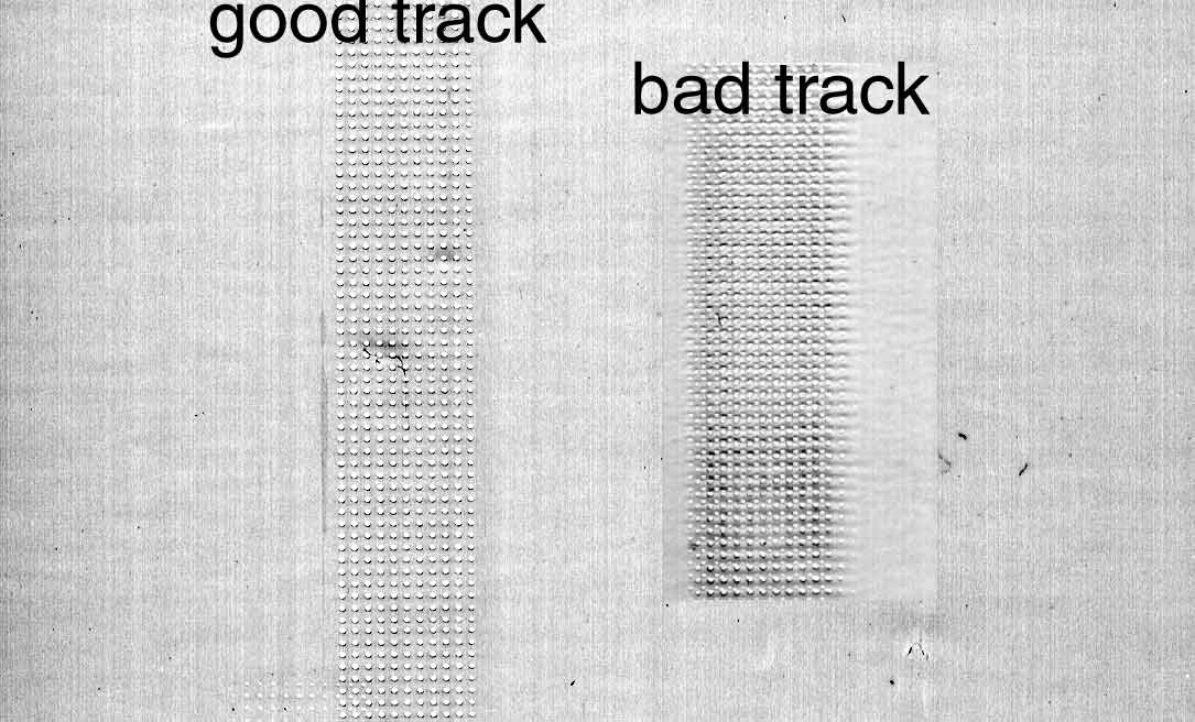

There are a lot of possible reasons why this could happen. You could check the back of your media for the tracking lines of the grit rollers, and compare it with the image attached. If you have bad tracking, it could be that your cutter have a problem (works with summa).
yamaha581
Thank you. We just got this brand new two weeks ago and it works perfect on the 30" material but this 15" material it seems to be going off for some reason. I will check it out and see what we can figure out on that.
