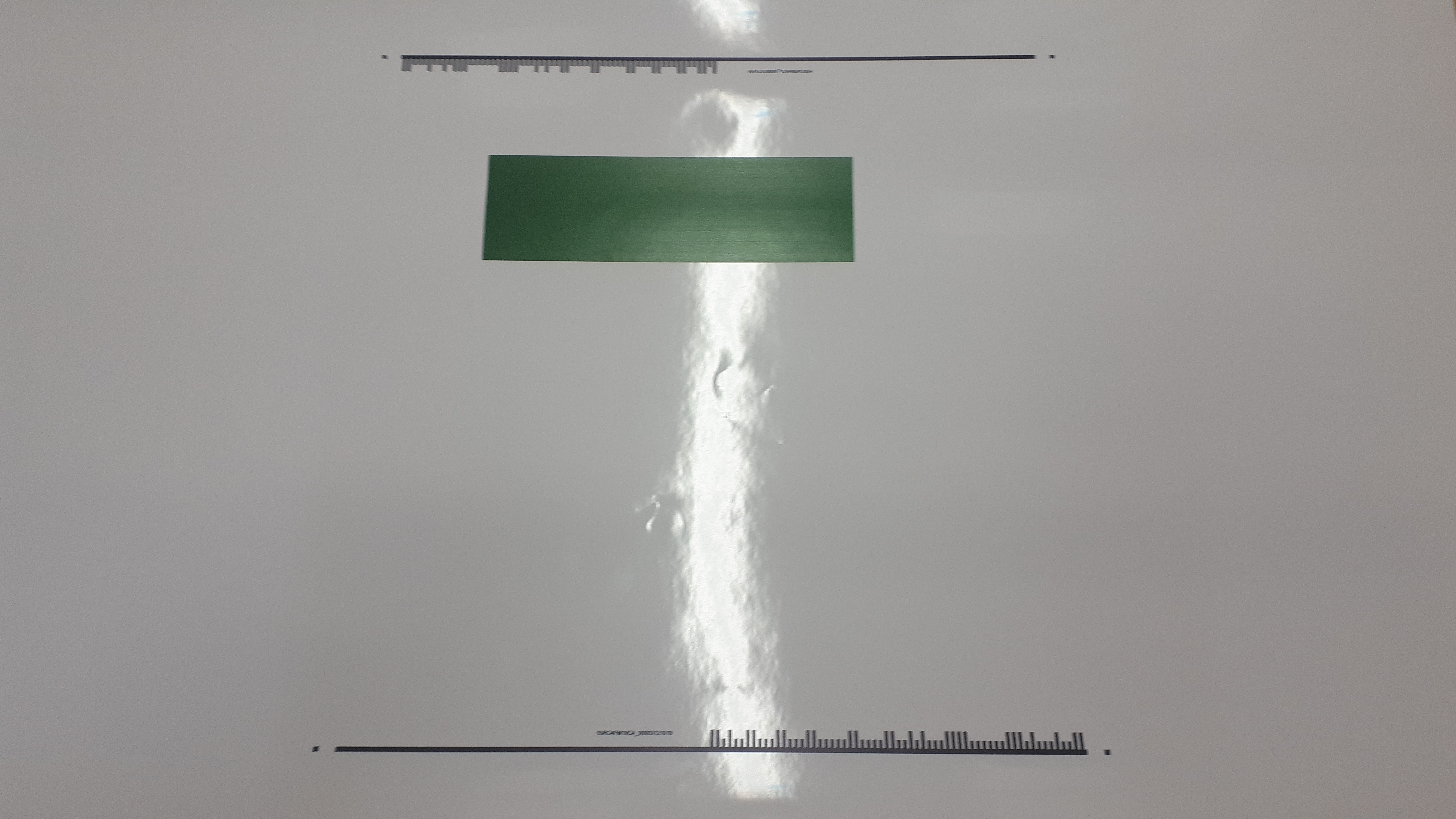

I have just started a new job at a vinyl company, they do NOT currently do print and cut but do have the machines to do this. But there is an issue as below that I CANT work out due to my lack of knowledge of MACS.
The rip is ONYX ver. 12.05.6302 on a PC which is printing to a OCE Arizona 350 GT
As you can see from the image we can print the vinyl with the Summa OPOS bar codes on.

In order for this process to work correctly you would need to use Onyx cut server to output your cut files if you wanted to use the barcodes. If you would like to output the cut files using MacSign you will want to use your design program(Adobe Illustrator or CorelDraw) to apply the registration marks as opposed to Onyx applying the marks. If Onyx applies the marks you need to use Onyx to output the files, regardless of whether you are using the barcode scanning or not.

We run our Summa cutter via network connection. Print thru Onyx with Summa bar code. File is automatically sent thru cut server to Summa bar code reader software. We load up our material and off and running.
