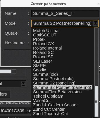

Can somebody please explain what driver I need to use as well as any specific cutter settings I need to setup on the cutter's control panel in order to use the barcode scanner to have an automated barcode workflow? I can print and cut a job with only reg marks, but as soon as I print the barcode and scan it, the cutter has no idea what to do with the info.

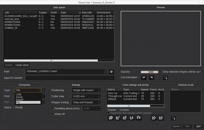

Thank you all for helping me with this. I do not see a "cut to file" option. Below is what Visual Cut looks like in Caldera V10:

I figured it out with some help from Summa. What we needed to do is under Type, choose File and then under Host, put the location of the Summa Barcode Server. After that, click cut and a .dmp file is generated. Once the job was printed, all I had to do is start the barcode server in Summa Cutter Control, scan the barcode by choosing OPOS barcode on the cutter's display and we were off to the races.
