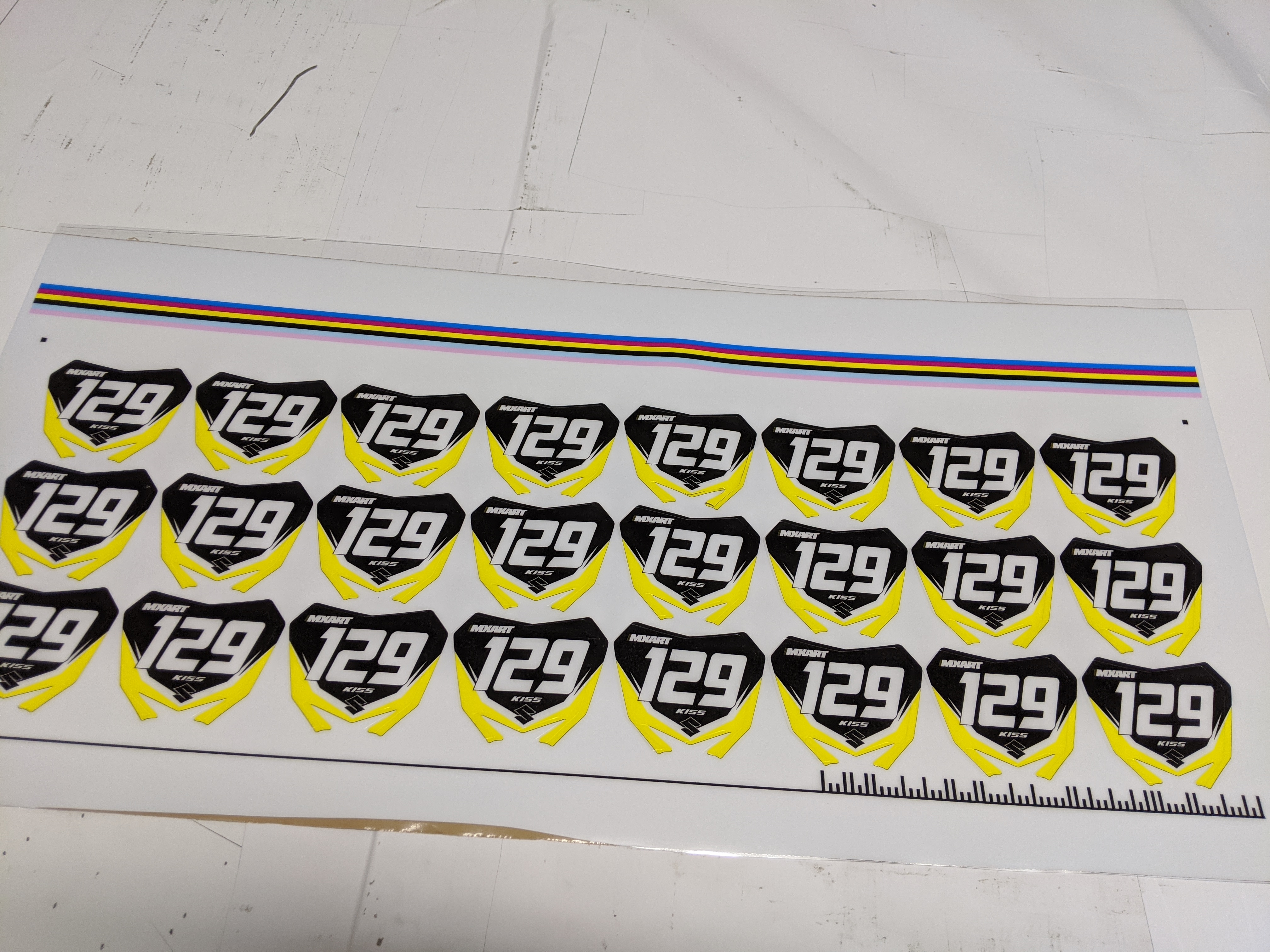

Cuts a job out mm perfect, next job 10mm off near the last opos mark. Next job 10mm off on the oppiosite corner, next job perfect. Exact same media exact same settings. Similar job length. I dont know. It doesnt seem like some minor tweek in the settings to be honest.

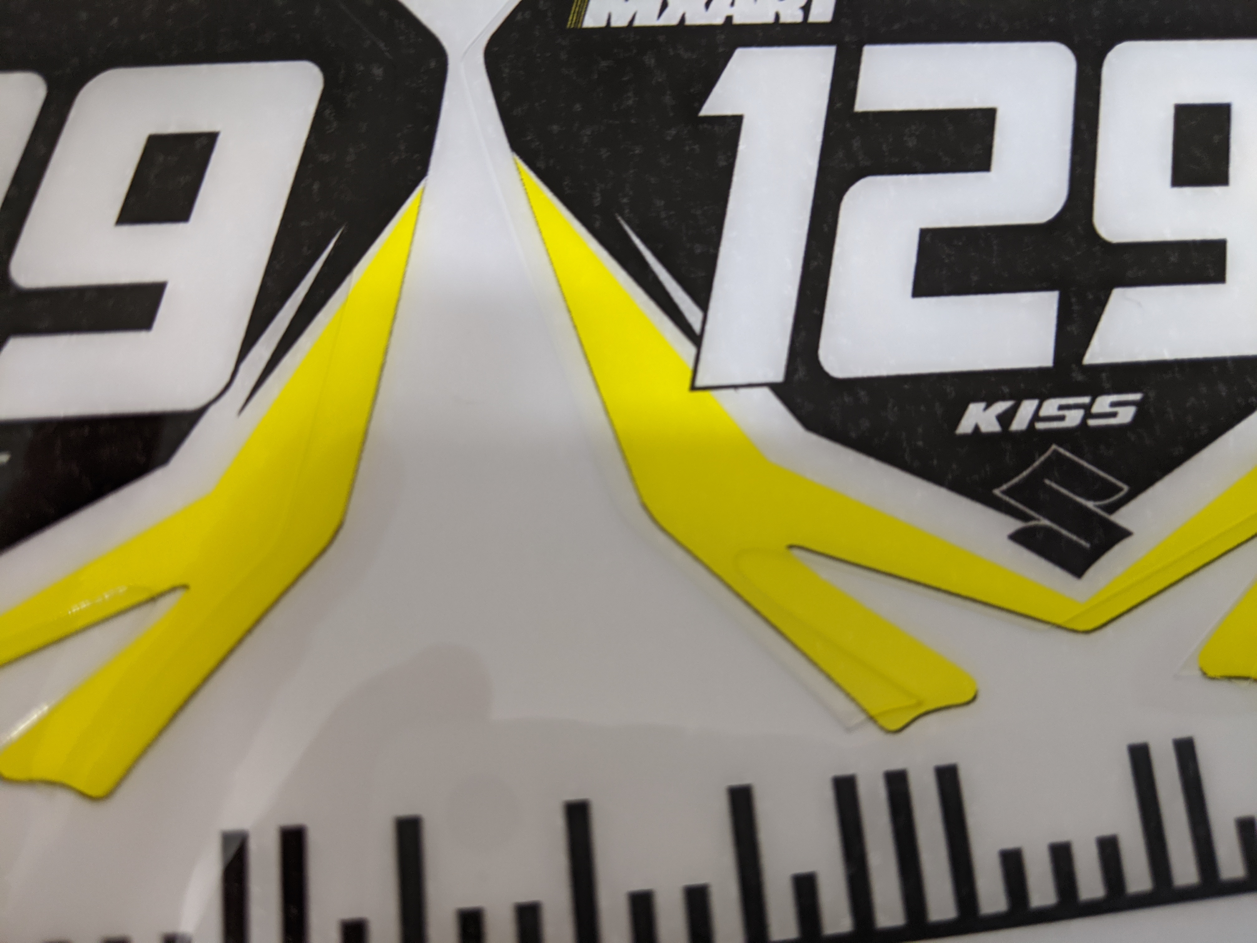

So kiss cutting 22 mil laminated vinyl, hardly a long job right.
At this point i had given up.

However as you can see on the images above it is off from the moment the knife touches down.
