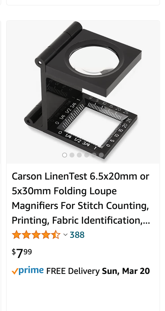

You are in the printing and Sign Business and you MUST Have a Loupe.
Get one of these on Amazon it will become your life long pal. is less that $10 so no excuses.
