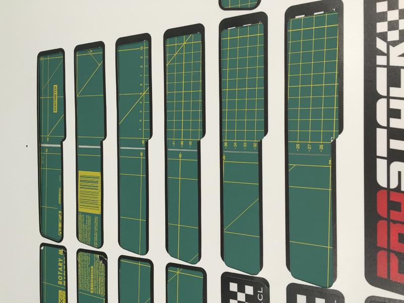

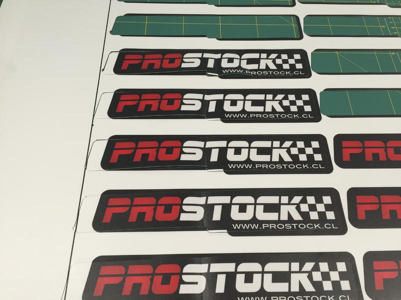

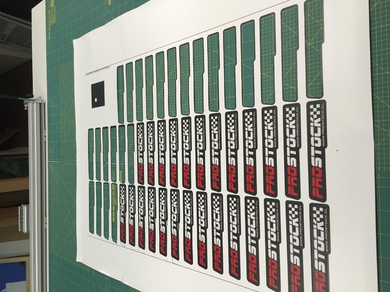

Im having a little problem while flexcuting:
I dont know why is this happening, printing on HP L260, using caldera s2 postnet and paneling to the size of the design.
The first row is perfect, but then the cut goes way out where it should be....
any ideas?

Assuming the media is not impacting other parts of the machine (media rollers for example), then you should slow the flex cut speed WAY down to a fraction of the kiss cut speed. Also, change the media feed rate in the maintenance menu to something much slower than default so that if the machine does the random cut routine it isn't moving the media too quickly which can cause it to slip in the pinch rollers.
Regarding the shape you are flex cutting, Summa recommends only flex cutting on the 0-90 axis rather than the angles and curves you are trying to do. This could be the primary contributing factor to the issue you are having (slippery material and angled flex cuts).

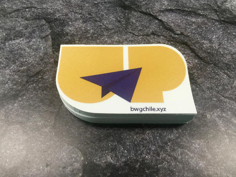

If anyone knows how to set up everything correctly or what can I do to fix the problem I´m all ears, we´ve learned everything we know from how to ensamble the machine to how to run it with caldera by ourself, no help at all from the "specialized technicians" from the dealer of the machine.

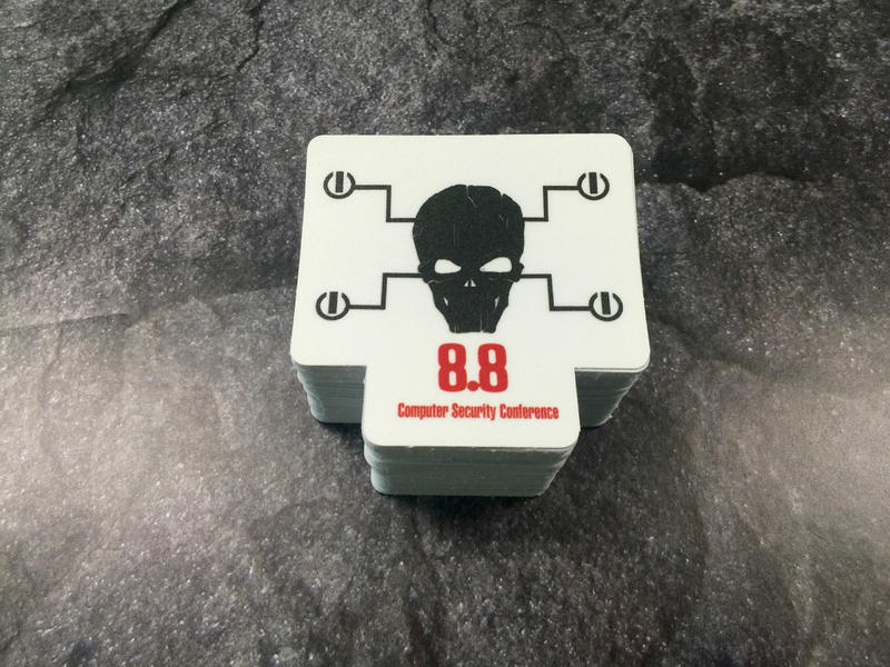

Yes, but the shapes are different. Print the shapes with the reg marks on the shorter side of the shapes you are cutting, increase the number of reg marks, try to place to marks in correspondence of the spaces between the lines and enable the OPOS Paneling option ( set On (4 marks) if you are using the latest firmware ). This will minimize the movements along X axes.
