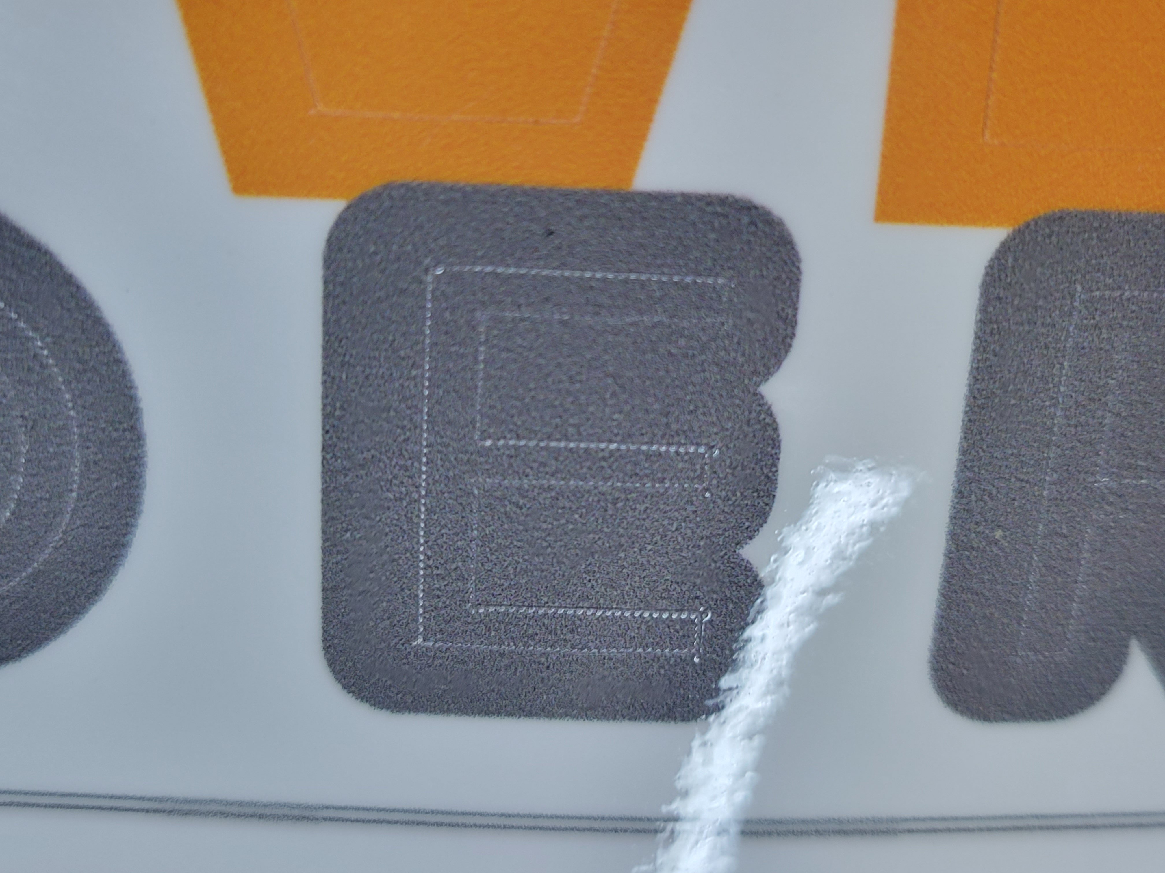

I'm using the 45degree tangential blade. I have followed the directions on blade depth and pressure. The speed is 12ips. I'm getting a really small rough edge look on cuts on laminated cast and calendared vinyls, even with a brand new blade. I have cleaned the roller thing right where the blade sticks out also. Does anyone know what could be causing this besides a dull or dirty blade or incorrect blade depth? We've had this machine for years and this issue is a few weeks old. It cuts through, it just seems like the vinyl is kind of sticking to the blade and getting dragged a bit.

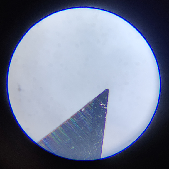

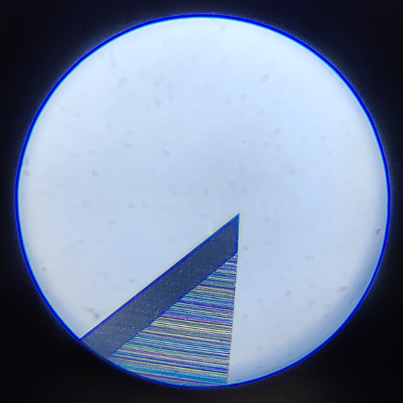

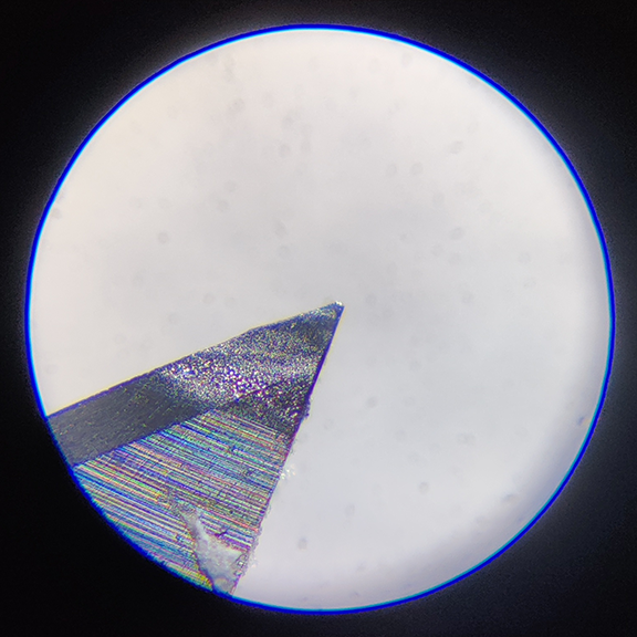

I often promote getting a cheap little Amazon microscope to check the blade anytime you have major issues. Especially if you're using OEM blades and are hesitant to immediately throw cheap blades at it.
Attaching photo of a new blade, a used blade that still works great, and a chipped blade that happened almost immediately after putting on. Sadly more common than anyone would like, and I think a lot of the frustration for new users who end up chasing all sorts of other possible solutions first.

How large is the letter "E" there?
what might cause a new blade to chip immediately?

Anything. Sadly they're super delicate. That's why I suggest a cheap microscope, because I think most people can't believe that the blades are really that prone to breaking. It's why a lot of the Graphtec folks are buying $1 blades bulk from China. I have yet to find great Tangential aftermarket blades, especially as 45°.
I haven't kept track, but I'd guess around 10-20% of my new blades break before they should... Meaning in the first couple hours or days. Tough pill when they're ~$60 each.

glad you got it sorted. 12 inches per second sounds like haulin *ss. How big is the text you are cutting?
