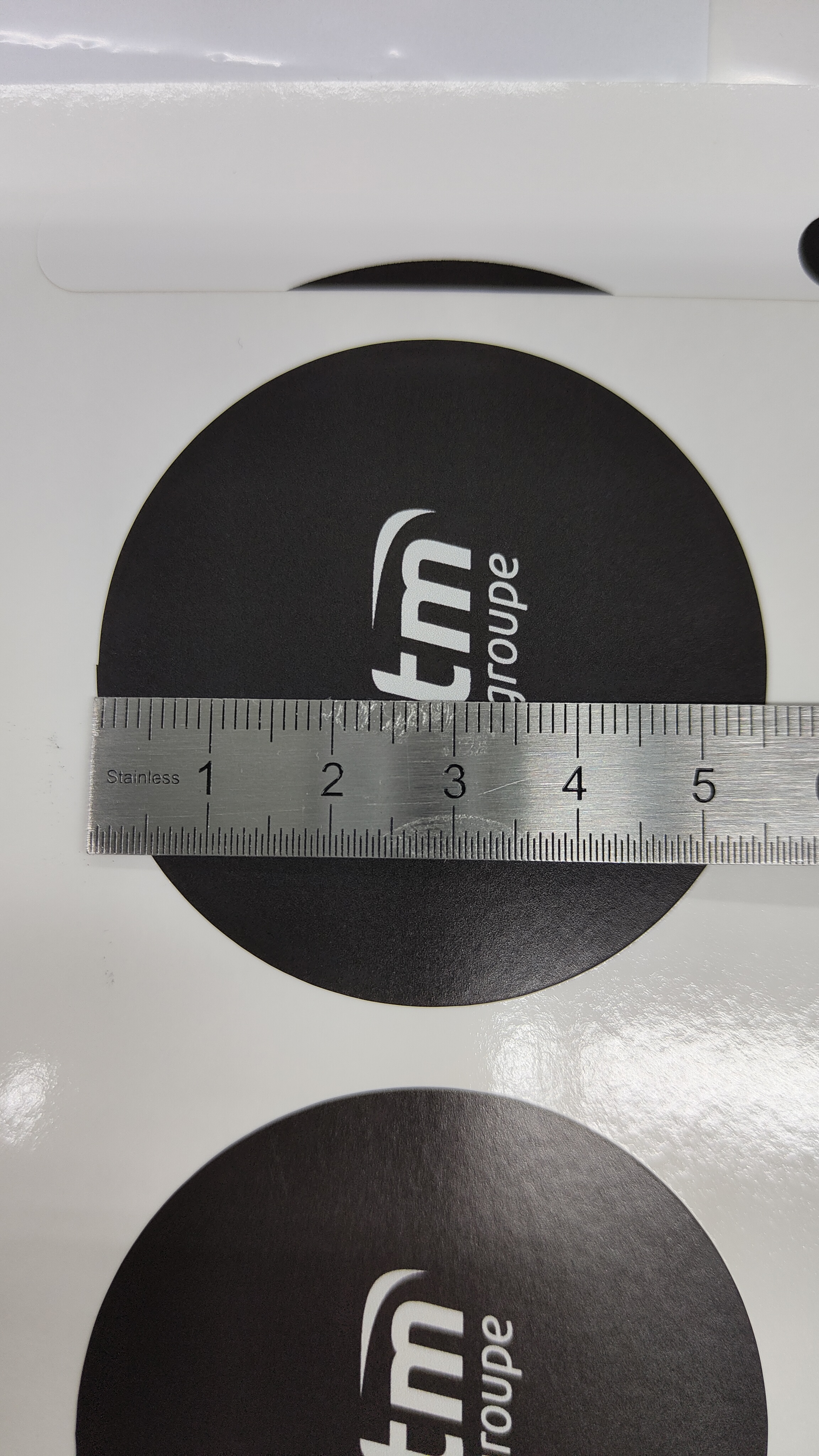

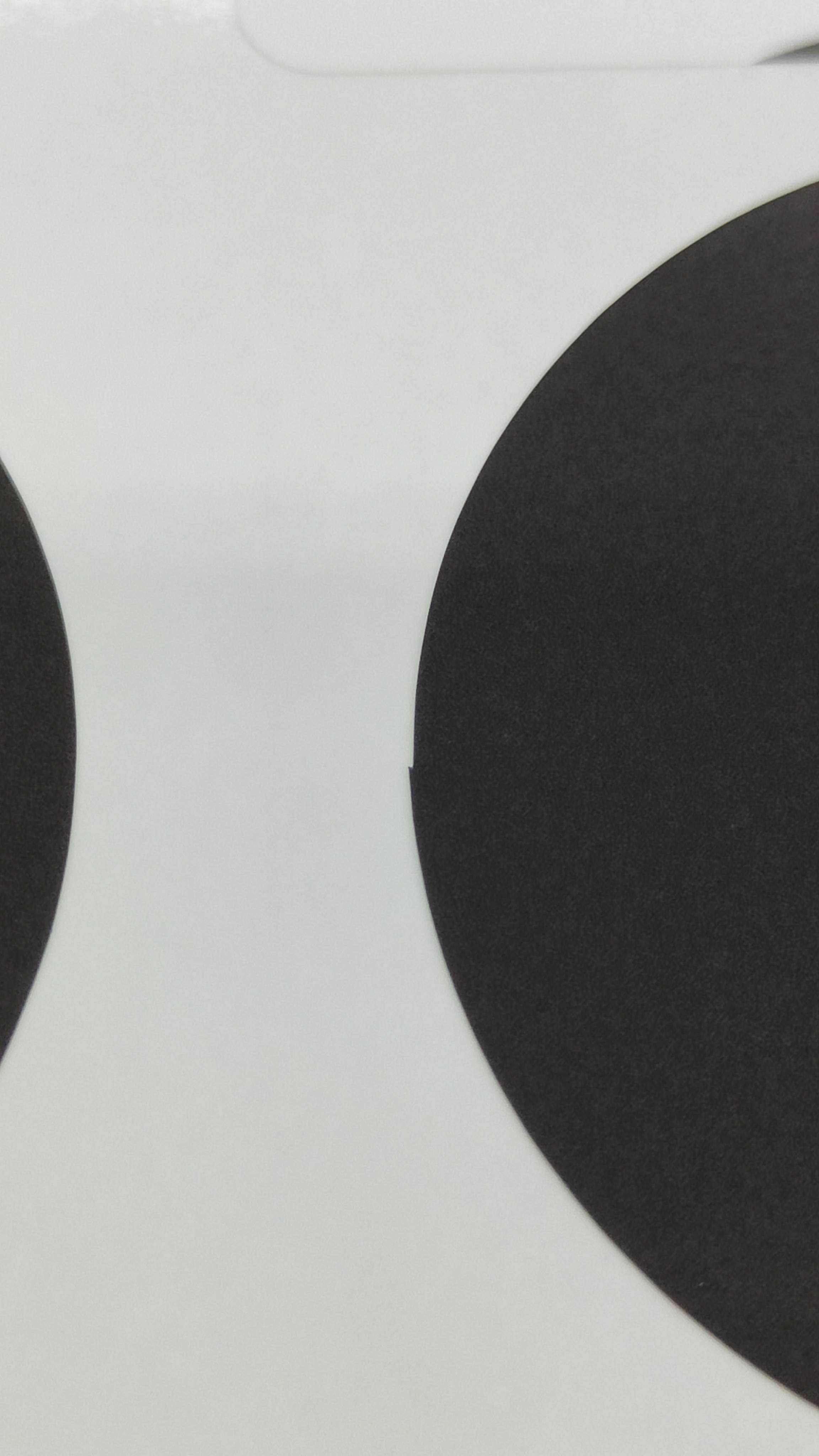

Since a few weeks we are having a problem with one of our summa cutters.
The start and point of the knife doesn't match anymore as you can see in the attached photos.
the starting point is always on the right side of the sticker.
a few things i have tried / replaced:
- new knife and recalibrated the knife.
- new knifeholder as i thought that one might been a little worn out.
- replaced the cuttingstrip.
- replaced the rollers
- we even replaced the Drive drum as we saw that it was unbalanced and you saw the pinchroller going up and down badly.
im out of options right now lol

Did you try to select ''starting point'' in the menu ''sorting vectors" from the summa ?
it was on off, so i put it on starting point but that didnt seem to solve it.
one thing i did check was the belt that drives the knife and noticed after that, that the knife didnt start correctly, although the knife calibration was good.
So it didnt start straight, but a little bit rotated. maybe the belt skipped a gear.
So far it seems to be good for now, so lets see how it goes after the weekend
