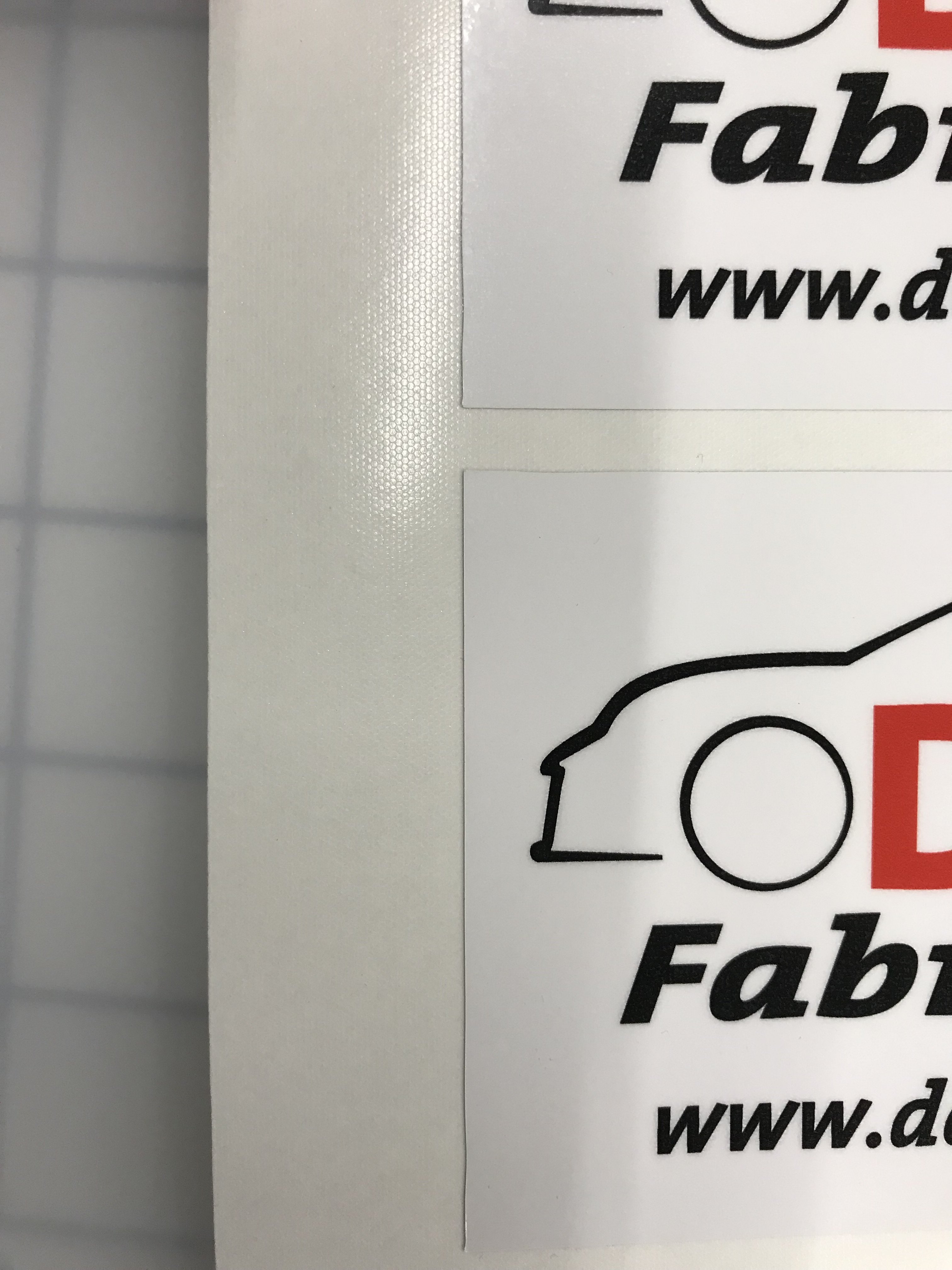

When printing on epson 80600 using onyx posershop and then send cut file to barcode server the rectangle cut line is not straight. If I cut straight from signlab to summa it will cut it out straight. Any ideas of what to fix?
klingsdesigns
Also when i tried straight from signlab i just cut on 651. When i did the print and cut i was using avery 2105 with lam.

Dont think about a data problem. Could it be that the media moves in the plotter? Is the problem repeatable, or dies it happen only once?
klingsdesigns
smoothing and opti cut are off. It was the same side of rectangle on all of the. But if i cut straight from signlab it cut it straight.

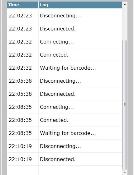

So i just got done hooking everything up to a switch. Barcode server will randomly disconnect from my summa cutter. Any ideas on a fix? It will go from disconnecting disconnected to disabled.
klingsdesigns
It will scan barcode and cut it. If it does it before it disconnects. Once it disconnects it just stops. I start barcode server button and let it sit and anywhere from 1-10 minutes it will disconnect on its own. I was told it’s a static issue. But shop is humid. I am headed to shop shortly to put all cords off the ground and see if that helps.
klingsdesigns

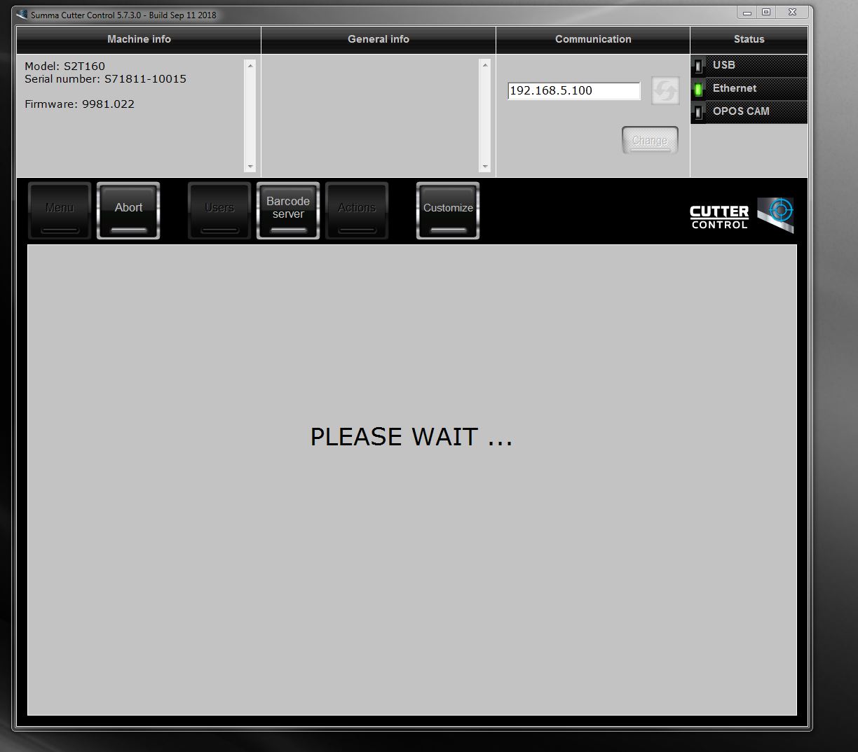

Also seems like with the 25 ft usb it will stay connected. I will leave it today and see how long it stays connected for on usb. Is the red light on back of cutter supposed to be read with the Ethernet cord in only? Mine does not light up. Only with usb connected.
klingsdesigns

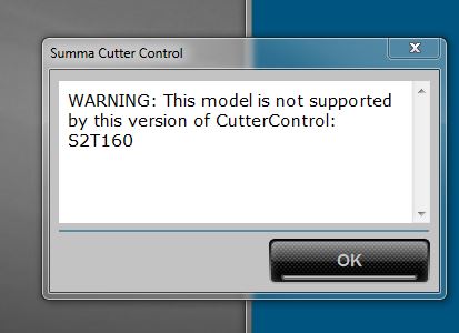

Couldnt find an update for the cutter control. But in the communication part hit change auto detect and if i either pick the ip one or the usb one it says please wait for a while and then no machine connected.
