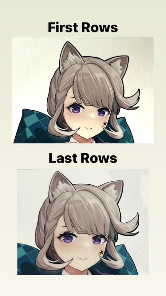

Does anyone have a problem with the cutter being 1mm off center vertically near the end of a cut job? For the first 3 rows it cuts perfectly center, but at the last 3-5 rows or so its always. Off.
I have ran almost 20 Opos Calibrations in one go, but still have this issue and the end of the cut job.
We also have additional media select rollers to hold the media in place, reduced the markers to every 5 inches, and we also do Opos 4 Mark Panel cutting.
The cutter is set up to cut pretty much as accurately as it could, and it does. In the beginning, but at the ends its always off almost like the batched job shrank a little.
Also, when we print and cut on 30inch material, some materials it does it, and some materials it doesn't. This time, we're on 54" material and it's having this issue.
Initially after doing the things I did above, it fixed the issue for about 5-6 months, but there is something happening now that must be causing this cutter to throw itself off near the end.
The rollers are clean also, and the bottom tracking marks are also clean.
Epson S80600, Summa S Class T OPOS Cam, Printed on Substance 2755 Vinyl and Laminated with Substance 3150

How large are these decals?
What is the width of the black border?
From the perspective of the pics you provided, it looks like that is within the margin of error. But there are three things you can check:
1. What software are you using to send the cuts? I would verify you are current on that software, cutter control, and the unit's firmware.
2. Have you changed your Cutting strip and Pinch rollers in a while? If not, you should do that too.
3. Change the length of your cut groups to under 10'. Tracking accuracy dramatically reduces over 10'.

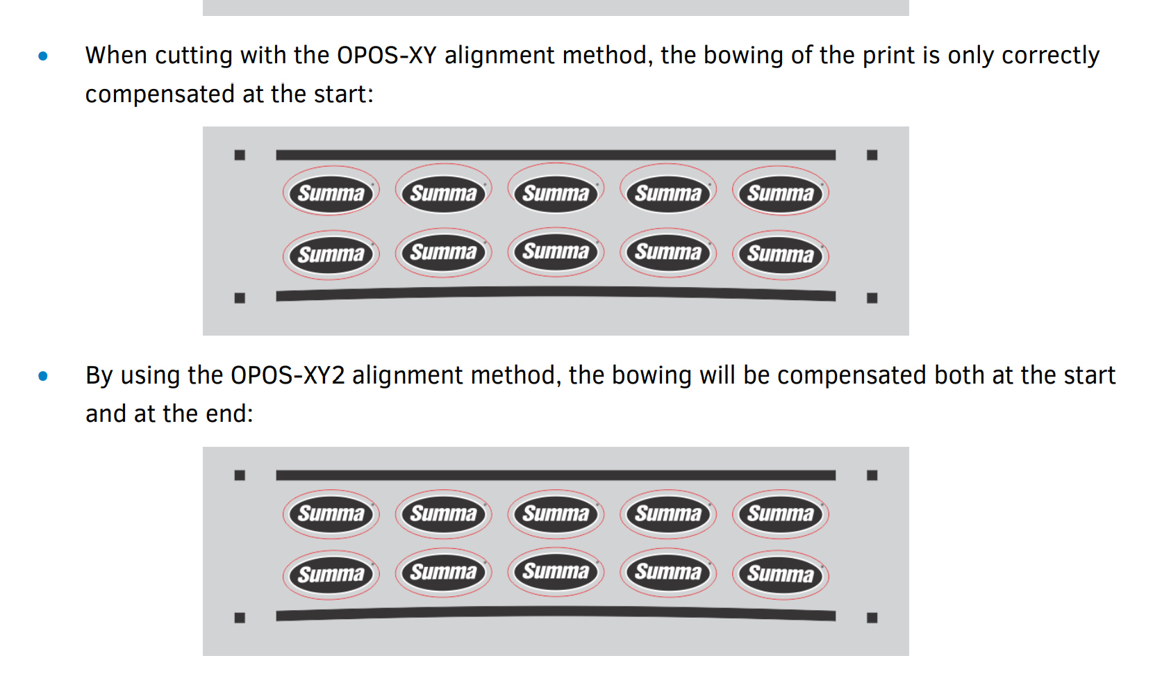

I ended up finding this while searching the web. Unfortunately for me I print with ONYX Gama Print which is extremely limited. I was told I need ONYX Thrive I would have access to the OPOS XY2 or OPOS Xtra options.
This can be confirmed in this video showing the workflow.
Manual where I found this information: https://support.summa.eu/support/solutions/articles/43000644736-roll-cutter-opos-alignment-methods
Unfortunately this means I will be stuck with this discrepancy until I dish out the $4k for the Thrive Upgrade.
