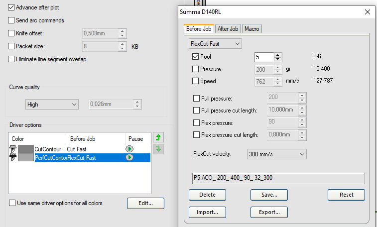

As a test......I added contour cut in flexi with grey cut contour in dropdown menu. then go back and add another contour cut but changing the contour cut dropdown to Perf cut contour. Send it to Cut/Plot. In Driver options I changed the PerfCut from drag knife to FllexCut Accurate. Then turned on the feature on the machine. As long as machine has feature on, it cuts Summa FlexCut.

I have "Send all colors" enabled in flexi and changed the tool in driver options so Cutcontour from drag knife to Flex Cut Accurate and set up pressure settings.. (Even though its a Tangential blade)

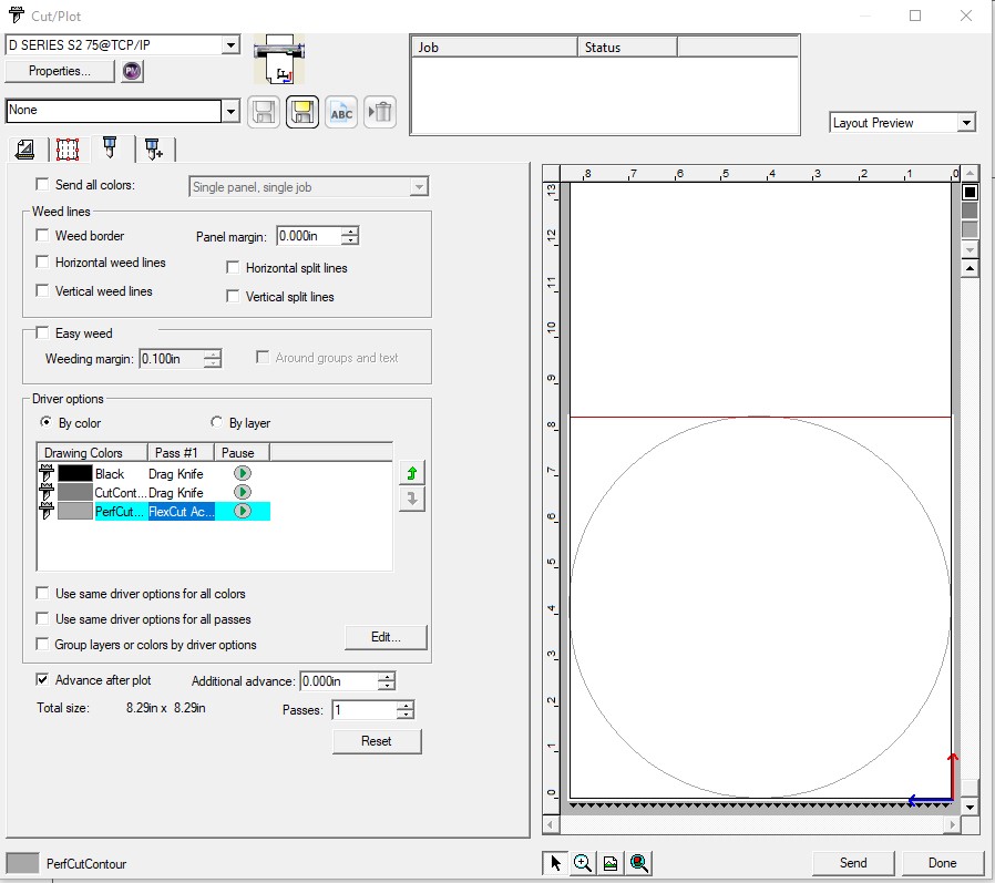

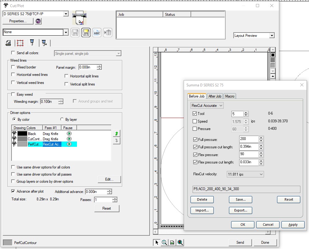

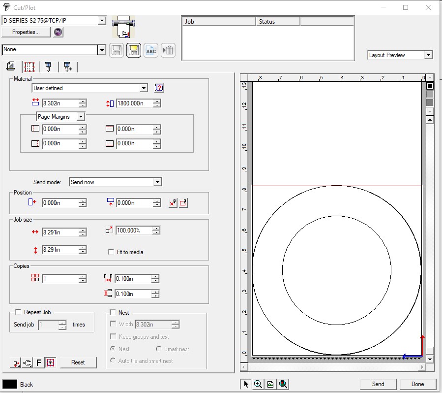

Screenshots..

What's that additional black contour? Remove that. Other than that it seems good to me. You can also try with Flexcut Fast.
By the way Flexcut is meant more for straight lines, not contours.

I have not figured out why flexi keeps adding the extra color. Other than it sees the color of the object. I can not remove it, just turn to turn it off from cutting.
I just drew 2 circles, 1 smaller and 1 larger, both with no fill with black stroke circle.
And yes, once again, it cuts regular cut contour. UGh.
