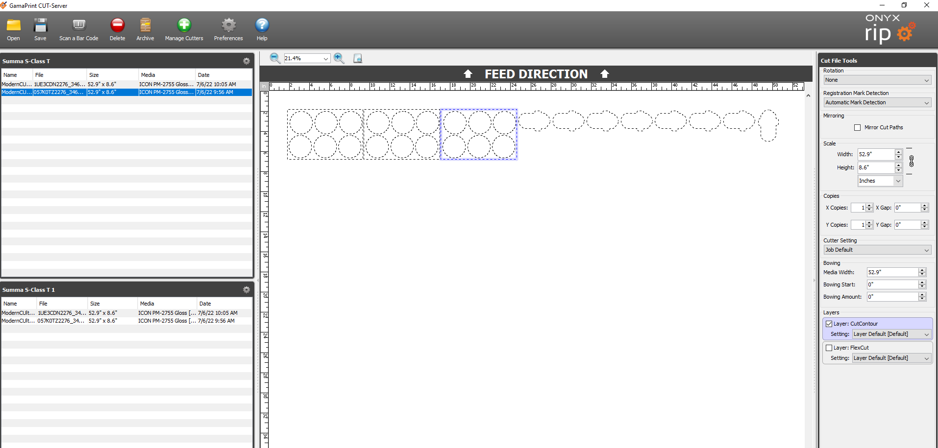

I'm trying to test this today, but not sure what I did yesterday to break the ability to create multiple layers on Cut-Server. I can create a new layer, but the layer disappears when adding anything to it. Unable to select the check box.
