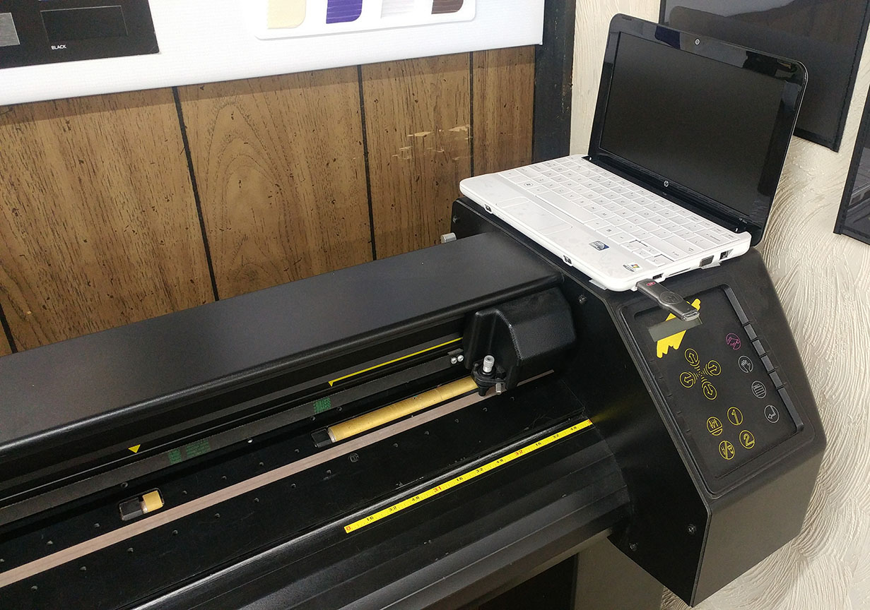

I use a D750 of that era and it works great and makes me lots of money. I have an old netbook with Windows 7 velcroed to the top connected via the Summa serial cable and a Keyspan usb adapter. I use Winplot to cut with and the setup works great.

Here is a photo of my setup. I don't connect the netbook to the net, I just transfer files with the jump stick.

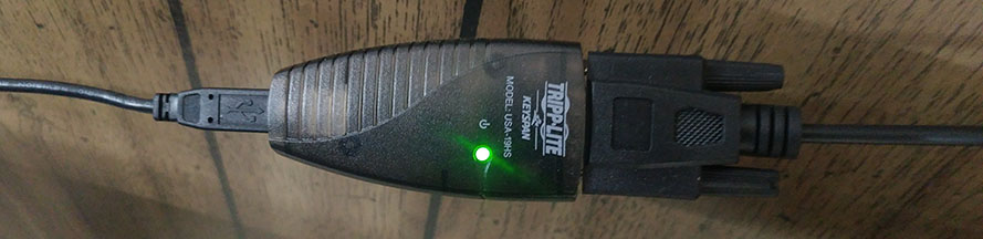

From my research this is the most reliable USB/Serial converter. Just make sure you install the Keyspan driver on your machine or it won't read.
Go to the Summa support website to download Winplot and applicable drivers.

Thanks for the pics and info of the nice setup hcardwell93!
