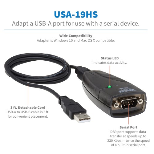

When I installed the Keyspan adapter, I also installed the drivers that accompanied it that were on a cd. I also went to the Tripp-lite site and downloaded the drivers for windows 10 and installed them. The laptop detects the adapter when plugged into a usb port and the keyspan adapter is listed in the device manager. From there I can view its com port number or even change it if needed. I matched that com port with the T750 and also cutter control.
Not sure if it matters, I have a gender changer also plugged in because both the keyspan adapter and the T750 are male plugs.

You need a serial cable to connect your plotter to the keyspan adapter. This cable must be an original Summa serial cable, or a crossover (otherwise called Null Modem) cable.
Right configuration:
Summa->serial cable->keyspan adapter->PC

If you need a gender changer, you shurely have a wrong cable. Is it correct that your cable have male on one side, female on the other? Then you have a simple serial cable extension, which is wired 1:1. The summa cable and standard null modem cables are F:F .

Took me awhile but I figured out what you mean. The problem I may be having is I omitted the Null Modem cable and plugged the keyspan adapter directly to the machine using a gender changer. I need the null modem cable to create the crossover which the keyspan adapter does not do. The null modem cable is female/female and would replace the gender changer. Does that sound correct?
This is the keyspan adapter I am using. I will purchase a null modem cable next and use both together.

jerry369 pointed out that I need a null modem cable in conjunction with my keyspan adapter. The keyspan adapter is male and the Summa T750 is male so I used a gender changer to plug the keyspan directly to the machine. Apparently I still need the null modem cable to make the crossover because the gender changer and the keyspan do not create a crossover connection. Does this sound correct?
