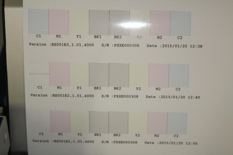

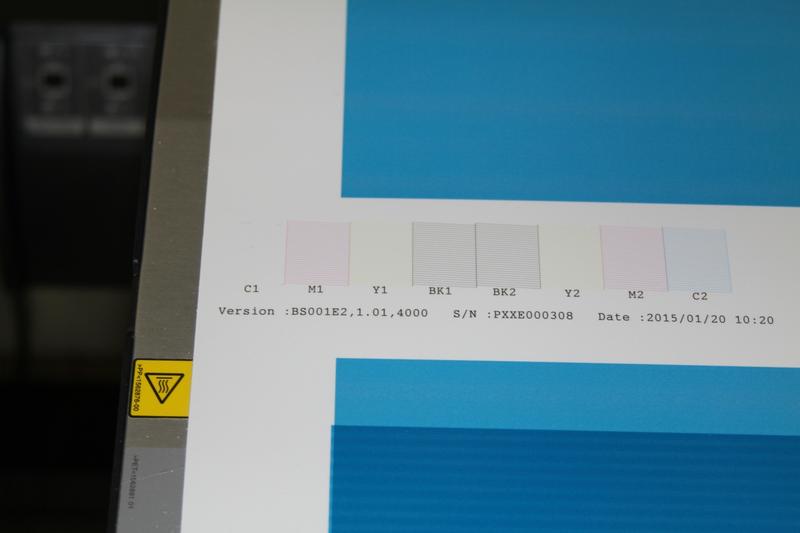

Have a surecolor s30670.
our cyan 1 head has started to not print.
started yesterday with intermittent ink dropout. now basically wont print at all.
1. have done several heavy duty head cleaning.
2. cleaned bottom of printhead and wipers
3. will do wash tomorrow when wash cartridge is in.
4. after one head cleaning all nozzles fired in nozzle check, then dropped off immediatley (see jpg)
not in warranty so epson told us to pound sand.
any thoughts?

Take a damper and a cap top and call me in the morning. If you were able to run a cleaning and the nozzle check looked good for a second but then dropped out, you most likely need a new damper and/or there is another cause of air getting into that channel. Check the ink cartridge to make sure there is actually ink in there. I have noticed ink cartridges not tripping the sensor lately. The cyan is on the outside edge of the head which would point towards a bad cap top as well. If you change those 2 items and still have issues, you might have a bad print head but judging by your pictures it is unlikely.
