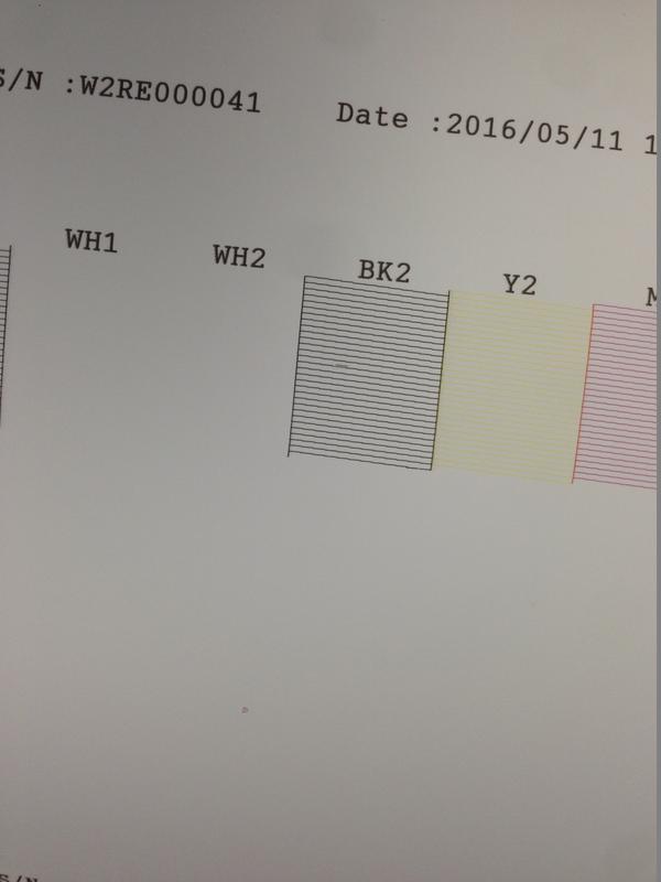

Lately when doing a nozzle check pattern we've noticed that on head two prints with a funky line overlap. Searching online we've determined its a "deflected" nozzle? Has anyone had a similar issue or have a solution?
jfiscus
Rap Master
Ours has had two or three nozzles like this since we purchased it (demo unit). We haven't seen any issues because of it.
ProColorGraphics
When I have had this, I would take a cleaning sponge soaked in cleaner and gently press it against the bottom of the head. Just make sure you don't rub it. Then after a cleaning or 2 it went away.
