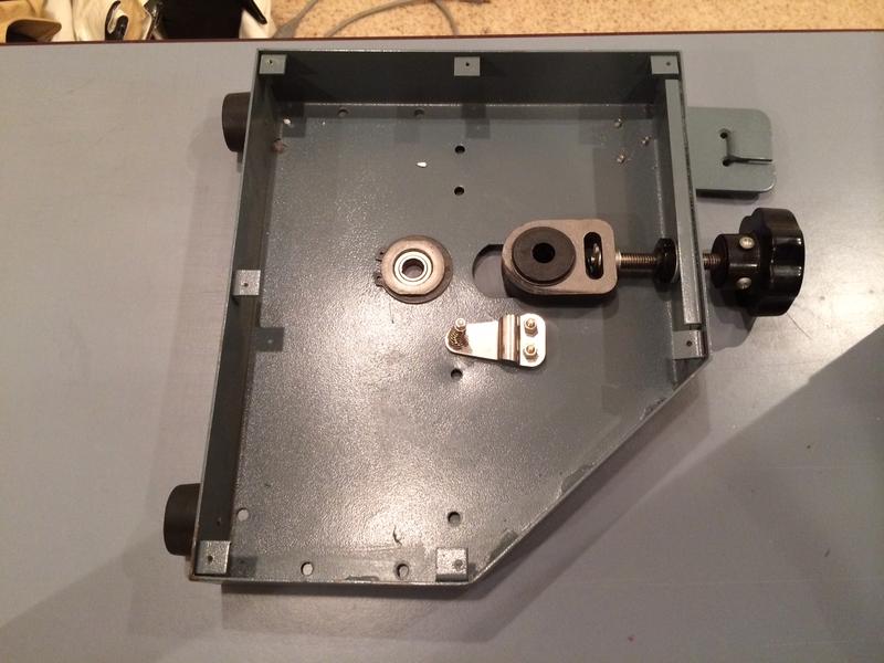

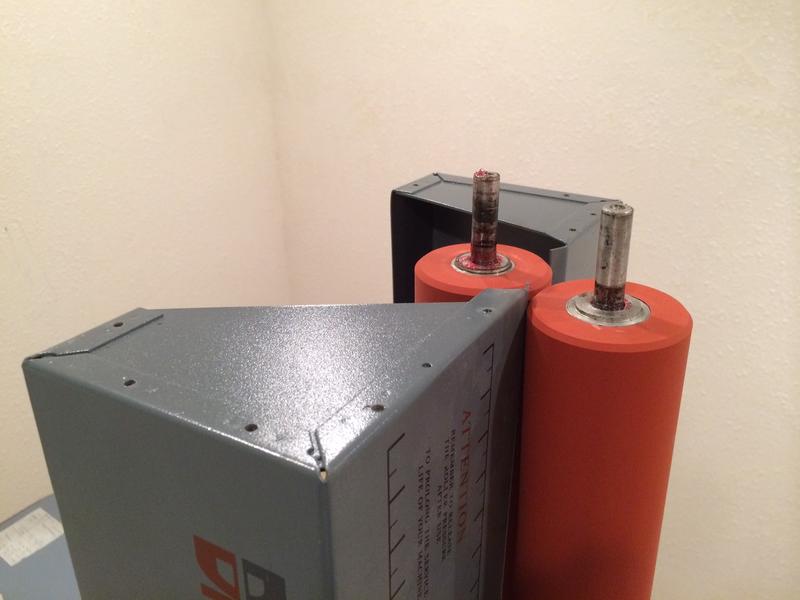

Well I went ahead and did it! Pretty straight forward if you are mechanically inclined. Bottom roller is/ was in perfect shape.
Model was a Drytac 26" cold roll laminator. I made a video of the steps and will put together if anyone is interested. awesome.
