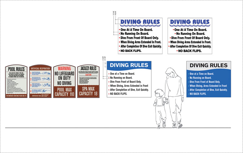

We have an extensive health and safety code... the best place to start is the state, then the county. Another good place is your local pool supply - NOT THE RETAIL SHOPS, but the place where pool servicemen go... My safety signs are designed according to architecture... not big on cute rule signs because inspectors over here have no sense of humor...
The 4 signs on the left usually make it through the code and safety inspection in my state....
