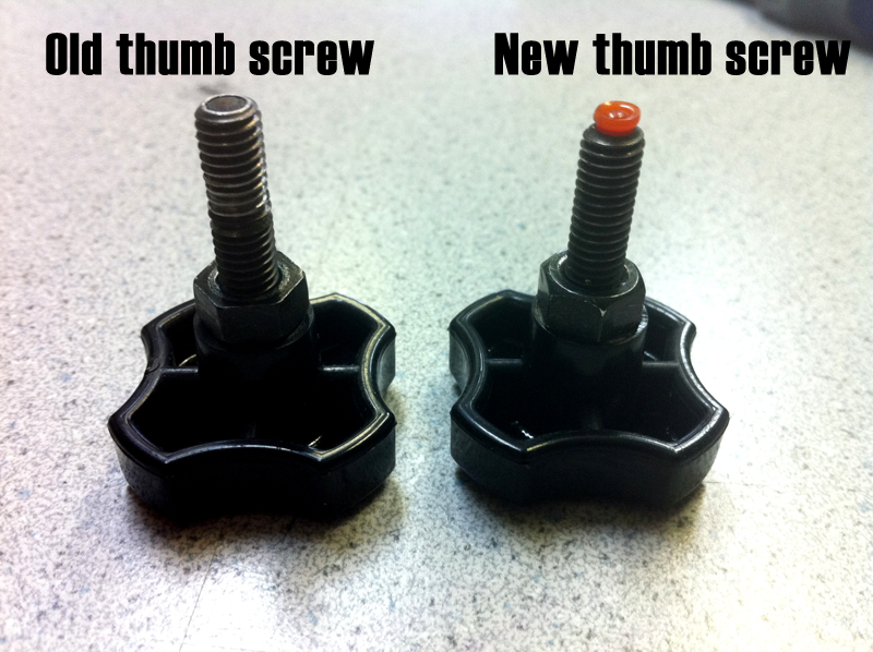

!update!
A roland tech called at the end of last week after reading this post, and suggested we replace the thumb screw. They fedexed it, and I just got it. I attached a picture of the old next to the new. It does feel more stable, and I will be running a long run this afternoon, so I will let you know if it fixes the problem. For anyone else experiencing this problem I would recommend checking the status of your thumbscrew and calling roland tech for a replacement if necessary.
ucmj22
The take up reel is performing better with the new thumbscrew. Still not perfect, but I think my stabilizing bar might be tweaked a little. Now my only worry is that I will have to replace this thumbscrew every 6 months. IMO the nylon nib is under quite a bit of stress being screwed in and out constantly. I know that a company by the name of Miner Elastomer makes some pretty incredible rubber/plastic products, some that are even used as buffers in High caliber military weapons, that could work well in this application. it looks like roland needs a new supplier.
