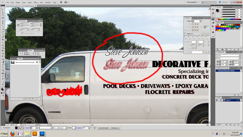

I work mostly in Illustrator - just upgraded from CS2 to CS5...
I need to replicate the shadow circled on the van... I don't know how to do that in Illustrator - but would like to learn... I've been using the program since Illustrator 88 :smile:
I also have Flexi 8.1 and Corel 13 if they would do the job better... but since I work mostly in Illy, I'd like to learn to do it there... if it can be done.

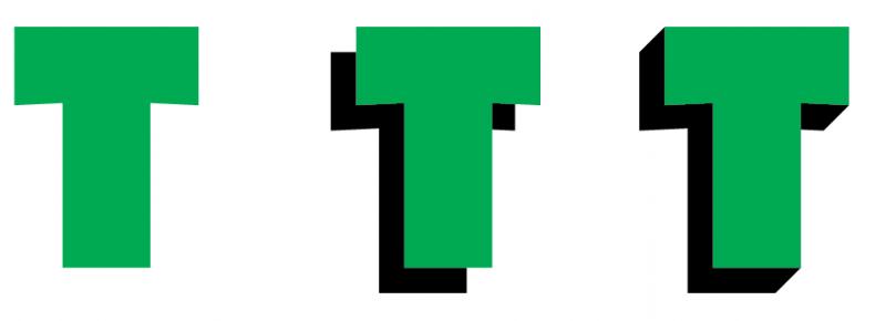

There is no easy way to do this. Some sign software has an extrusion shadow which is what you have here. It is 1 or 2 clicks in sign software.
The only way I can do these in Illustrator is to create a regular shadow and then "connect" the 2 shapes with the length of "extrusion" Not too bad on a few letters but can be cumbersome. There is a 3d tool in Illustrator but it is not vinyl friendly as it creates many extra unneeded shapes

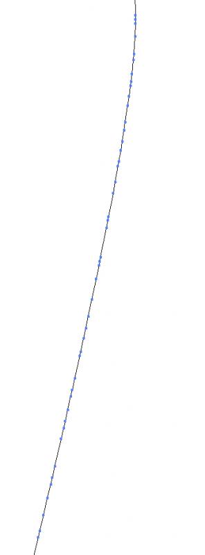

These options still create a file with way too many points or stairsteps. The blend options will give you an edge with possibly 20-100 too many extra points.
I guess I am a perfectionist and I think my customers expect something better
