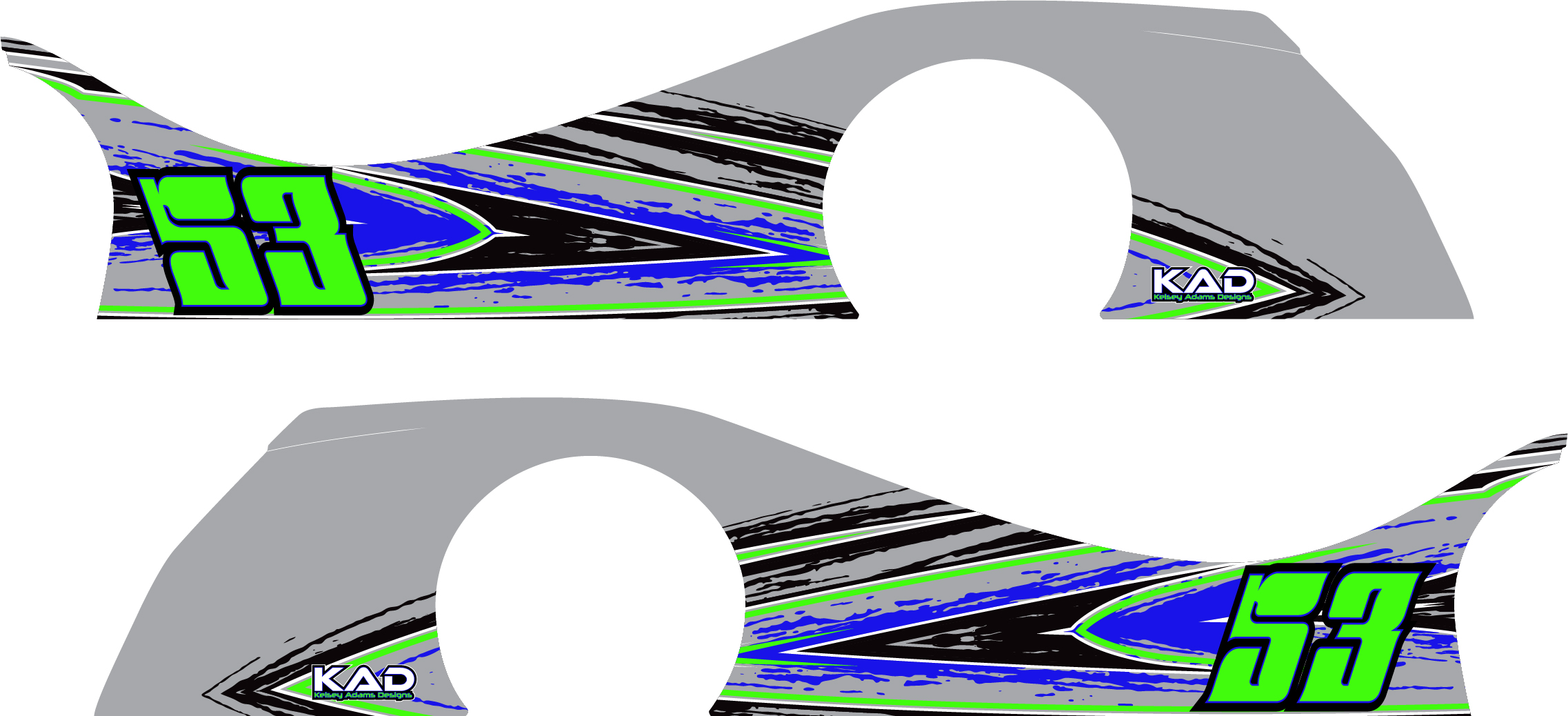

I have a template from SRGFX that I already have my design completed with. How do I go about just being able to print and cut what design I have showing within the clipping mask without having to print the entire design and then having a bunch of scraps? I can only seem to add a contour cut to the entire template, which I don't want.

Can you divide the template in the plot/cut screen? In Signlab, you can go to the top or side of the item to be cut ( it’s a blue or green line) you can pick and slide up or sideway, and as many sections you need. You then pick the sections you want to cut. Hope that helps. Good luck

No gettin' around cutting extra. All that should be accounted for in quoting. You charge by the linear foot. Templates are only to be used to give a "rough" proof. More precise measurements before printing are done once the vehicle is on hand. Look for natural breaks and set up print panels accordingly.
