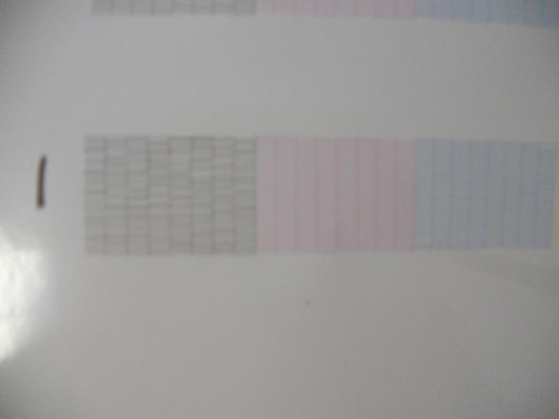

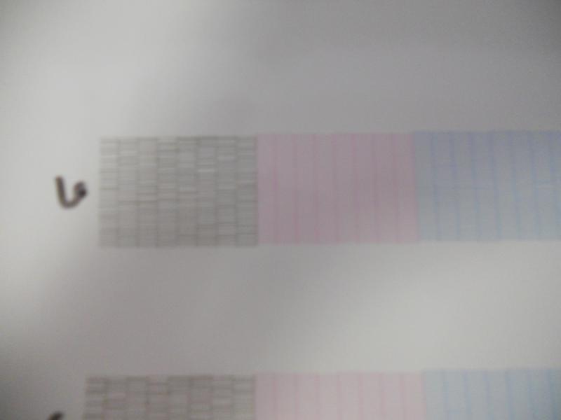

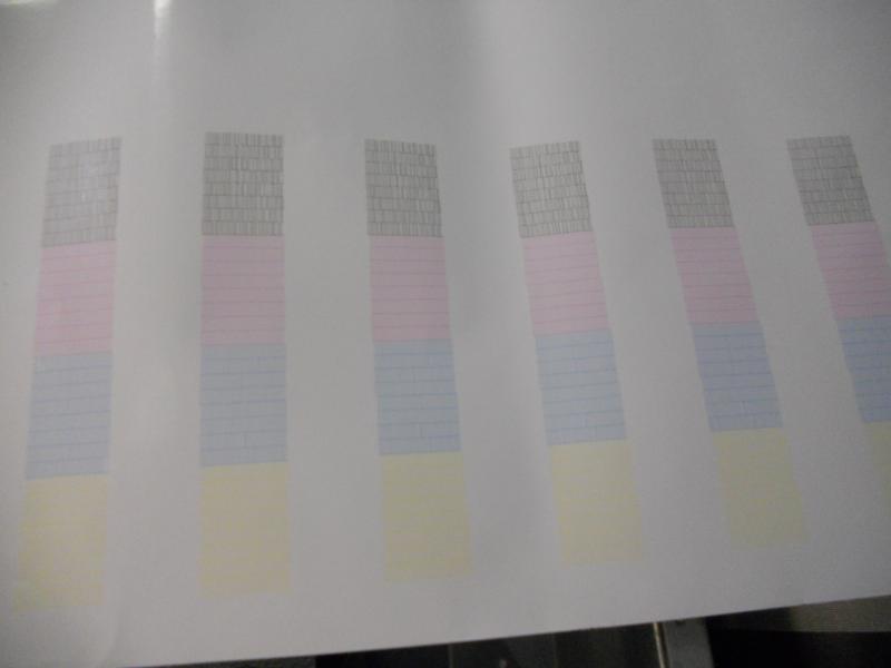

My test print isn't correct, I have attached pictures so you can see what I mean by incorrect. This has been running this test print for a few months now... but before today I wasn't sure how to even start fixing it... So far I have ran:
- Replaced wiper
- (6) Head Clean
- Nozzel Wash - 30 minutes
- I clean it almost every 2-3 days, clean the capping station and heads.
- I have checked the heads for any ink or debris build up.
Oh also, I have labeled the test prints (1 - 6) (the long one isn't labeled, but the test prints go from (1) left to (6) right. 1 was the first print and 6 was the last. There seems to be a little bit of improvement but not much... any help would be much appreciated.
-SAR

i have had no luck here is what i tried .... head soak. nozzle wash, new wiper, pulled dampers fluched with solvent till clean , while dampers are off i pushed cleaning solution threw the black head, (only the left channel is where my problem is exactly as yours is) filled up ink, pulled black suction down at pump, slid head over all the way to left cleaned it perfictly clean, did data cable swap, its killin me
