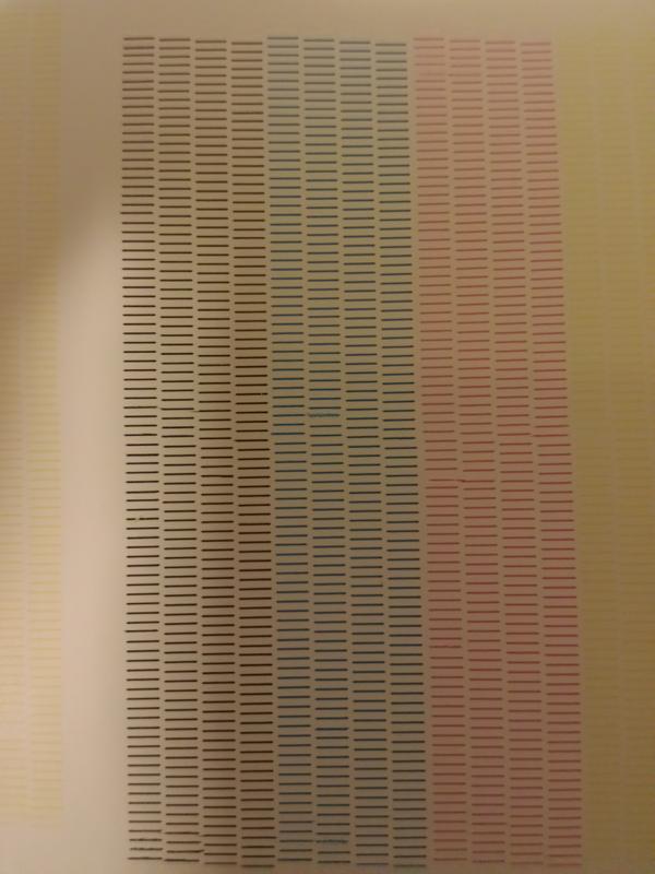

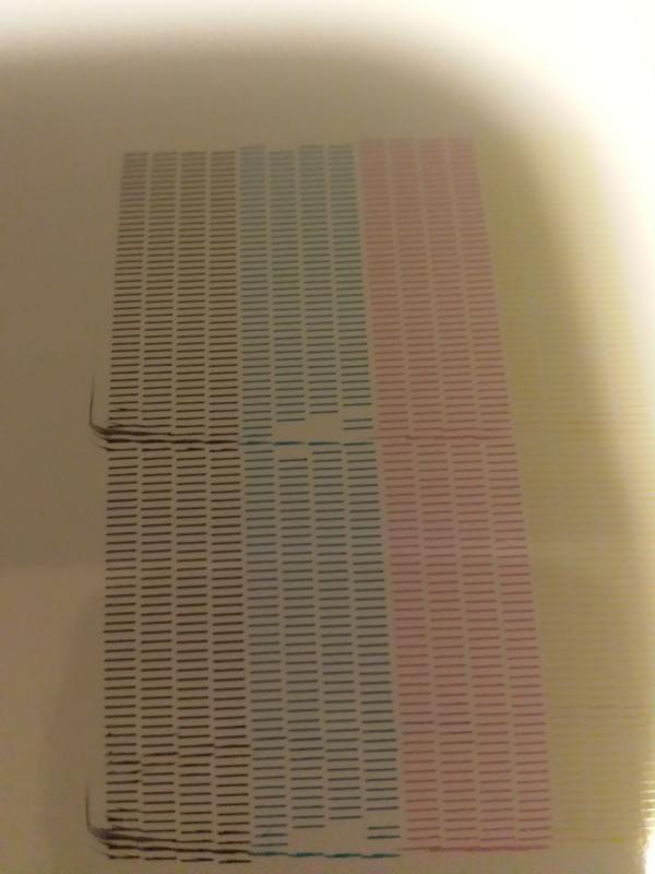

SP 300 V -- just need a little advice please, I recently switched to Bordeaux inks after using brand X for 3 years, seems to be working just fine, then I changed wipers and sponge, along with a manual cleaning, after a couple days my test print went from great to horrible, looks like lint or something might be stuck to head but I see nothing. I've tried to fix it by inspecting wipers, medium head cleaning, manual cleaning ,
any support is greatly appreciated and thank you
before & after pic attached

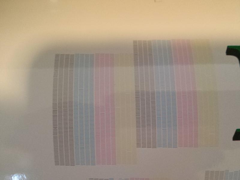

just fixed it, there was a small build up of ink and lint in that black frame just right of magenta/yellow head.

Jackpine
The patterns look the same. It looks like lint on the head. Clean around the head and soak if needed.
