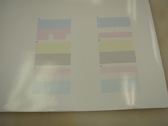

Yeah that is half my problem. So many possibilities I need to knock out. Here is what the test prints look like.

petepaz
if that doesn't work you might need new capping stations
we justhad to replace them in both our rolands
not too bad cost about $23-29 per station
and you can put them in your self
petepaz
last post was before you posted the pics
did you try putting a new magenta cart in
which roland do you have
petepaz
i would just change the magenta first it seems that is the only color you are having a problem with

If the new caps do not fix the issue, you may need to adjust the position of the heads to the capping station. Look to see if the heads are capping in the center of the heads...if not, call your local Roland tech... it takes about 5 minutes to adjust. New caps will not cure the adjustment issue (if needed).
