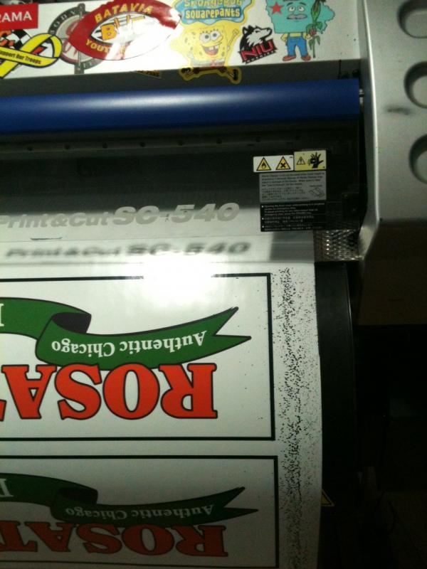

Spitting ink on right side of print
Getting very frustrated! Attached are two photos of what my printer is doing.
To review we have changed to new Roland caps, new wiper, new sponge and the drain tubes are clear and use Lyson ink.
Do caps need to be aligned?
Also anyone kind enough to forward a manual, it would be wholeheartedly appreciated!
Thanks for any and all help!:frustrated:

20/20 ink used to be eleven ten ink that did a lot of damage to printers, had many law suits and then changed there name to 20/20 inks. They damaged my sc 540 and have problems with color shifts. Run, run Forest as fast you can. Solaris is good 3rd party ink, no problems and they put more ink in each cartridge than Roland.
synergy_jim
switch back to roland ink, swab your heads with cleaning fluid, and run a few powerful cleans followed by medium cleans until the head comes back. I used the same inks for about 3 months and we were able to get everything back after switching back.
