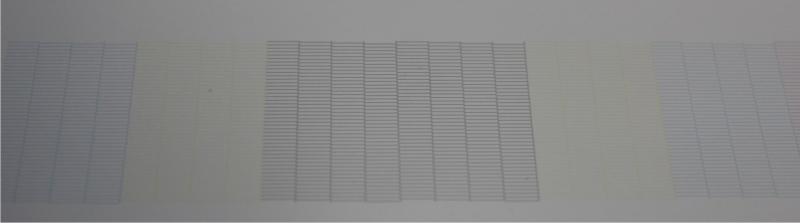

Does this test print look alright? I just noticed on the top and bottom the boxes are not complete.

That's normal that the top and bottom edges of the test print don't line up. If you see gaps in the middle of the patteren, that is when you are having a problem. Your test print looks perfect, make sure you continue a good maintenace program so you keep it that way always!

Yup- looks like a perfect DX5 head test print to me too. :) Wish they stayed that way forever.... Just replaced the head on my JV33 and it's nice to be back to perfect again.
