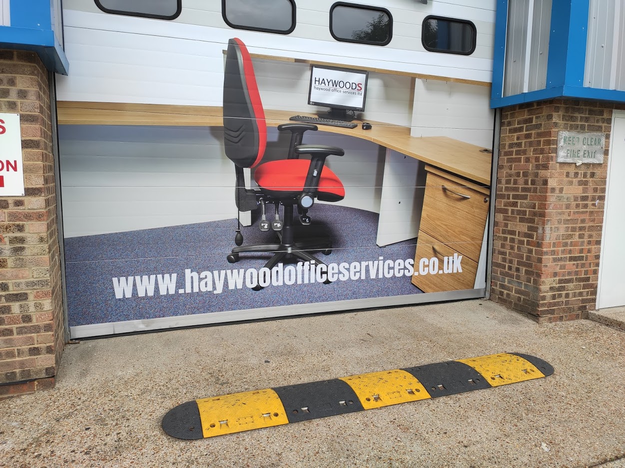

On textured surfaces, before you peel the transfer tape off; go over the graphic with a rivet brush...rubbing in a circular motion. It will help push the graphic down into any recessed areas.
As has been suggested, use a RollePro, rivet brush, gloves or whatever means you can to work the vinyl into the texture and post heat. We put Oracal 751 (I would strongly recommend cast) on two sets of garage doors about four or five years ago and they still look great, although they were brand new doors which probably helped.
