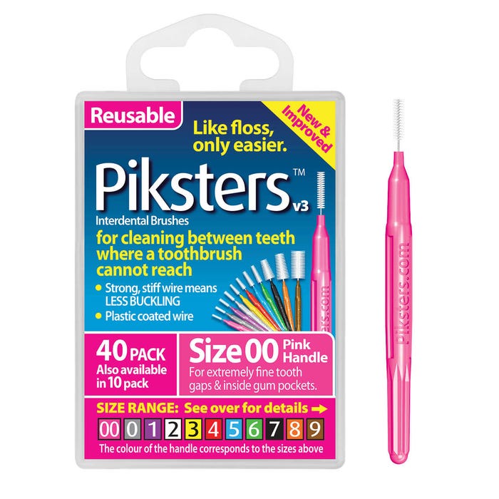

Also, use "Piksters" to clean the platen holes (image attached), much better than a paperclip.

Piksters - top notch idea, why didn't we think of that. :)
