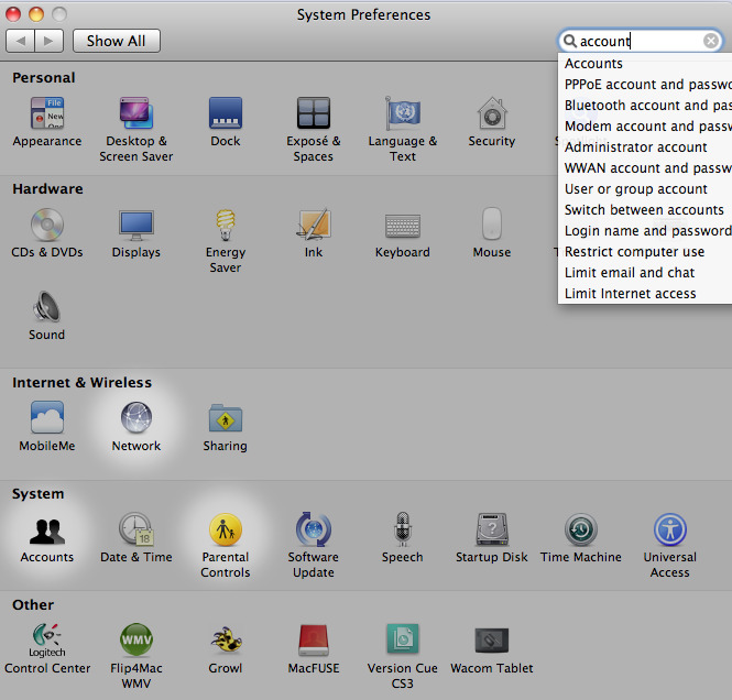

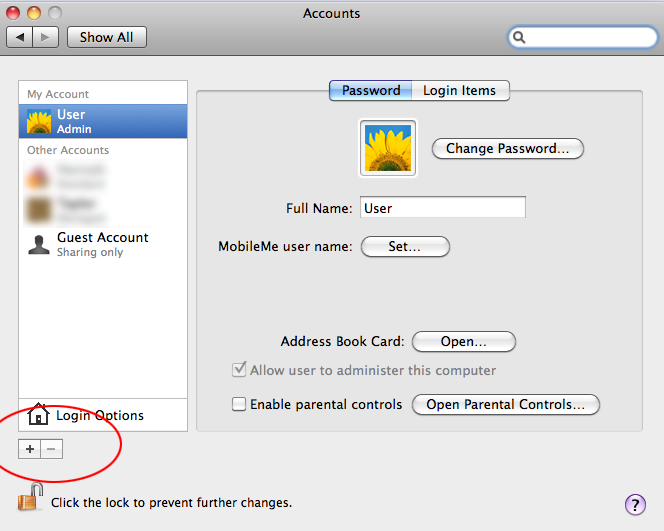

System preferences, click on Accounts and then click on the + symbol. That way if you have multiple users on your computer the other users can login to their own account and have their own "dock", backgrounds, passwords in Safari, itunes, photos, etc etc. Even if you are the only user it is a good idea to create a unique account for testing problems. Let's say you do have a program that keeps crashing. You then can determine if the problem is with the whole program or some corrupt file on your account. If the problem goes away with the test account, then you know the issue is a corrupt file and not the whole program
There are numerous other advantages to having alternate login accounts, but that is for another time/thread

Eric, I think I'll try that this weekend if you think there's a possibility of that...I didn't think that just another account could fix that. I just put a new hard drive in it late last year, so it shouldn't be too whacked out, but there's always a chance I guess. I'll give that a try and see if it'll let me burn anything. Can I drag files between users or am I going to have to create all new files to burn?

It won't fix the problem per se, but rather confirm if this is hardware or software related. Copying files from account to another is ok if you are desperate but only wastes space as you will have a copy twice on your hard drive. If the problem goes away on the 2nd login account then you know it is a software issue and likely just need to reinstall the OS. If the problem persists, then you can be almost certain it is hardware related
