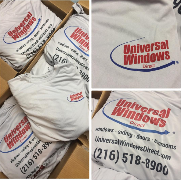

I just did a 200 piece order of poly shirts with 2 color screen printing on the front and a full sublimated back.
Came out pretty good. Sublimated back, even after I suggested a screen print instead of sublimation, they insisted on it because they were installers shirts and they did not want them to have heavy ink on the shirt (Sweating while installing windows, window, roof and siding company)
