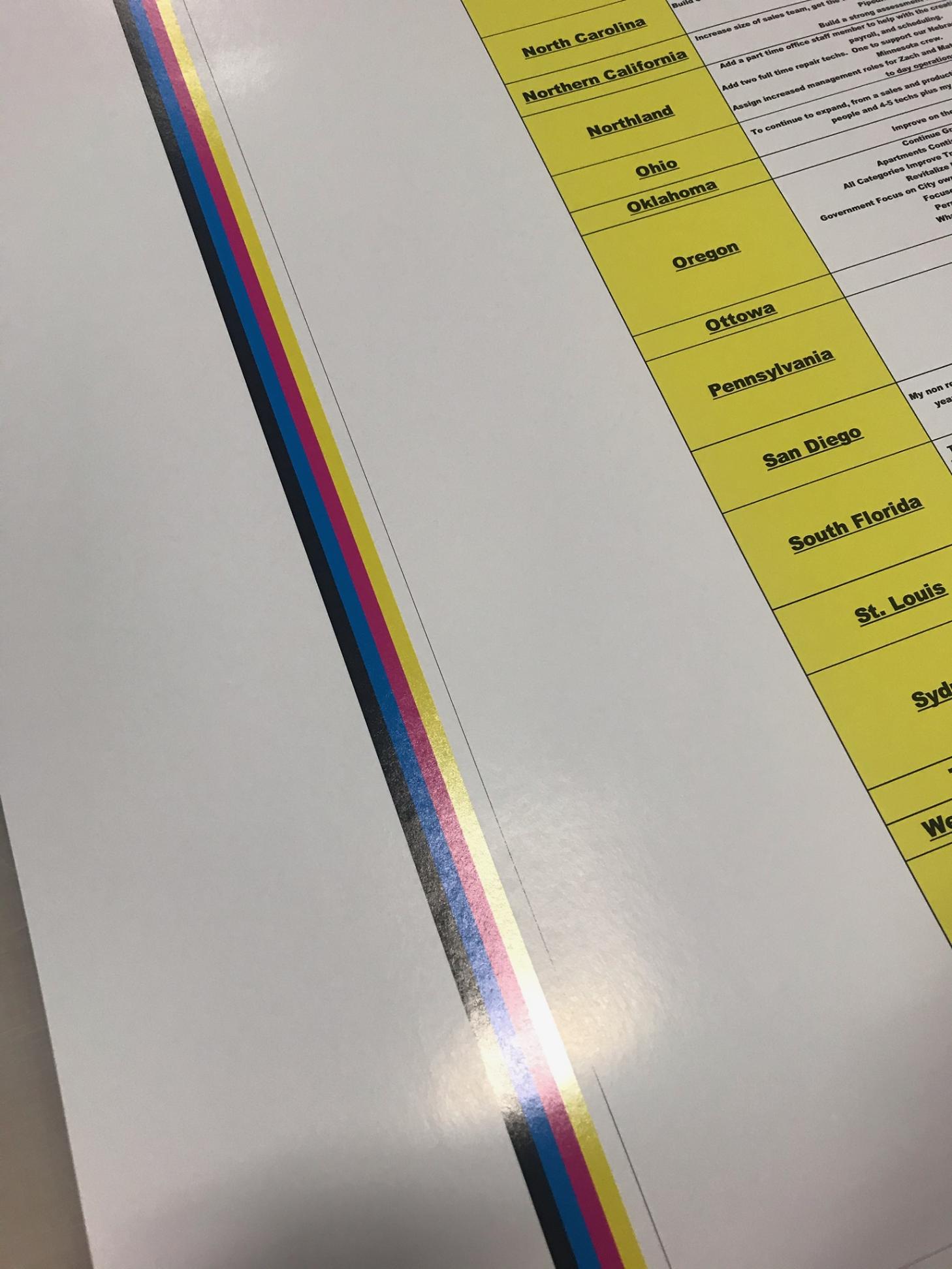

Today our s80600 started printing these lines on all jobs. They're showing up in the print preview on thrive 19. I'm guessing one of the guys clicked a button they shouldn't have but I'm not sure where and I'm stuck at home so I can't look at it and figure it out.

Its the Print Gutter. should be in the placement setup window
