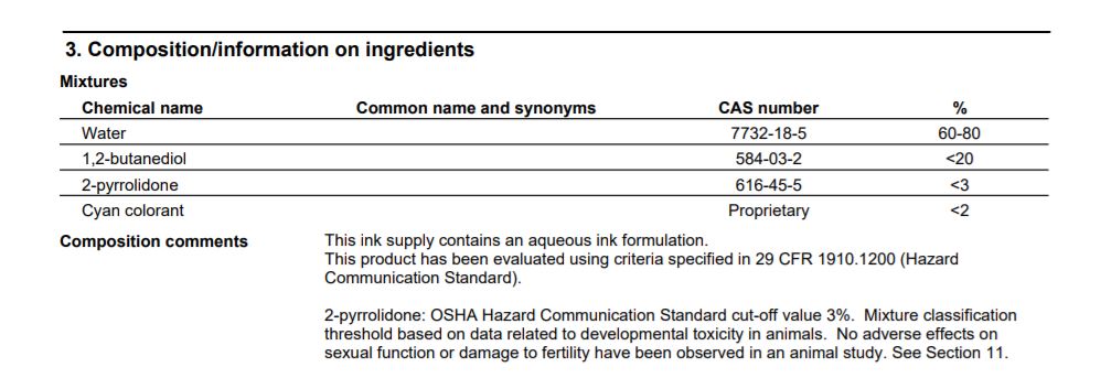

I thought the name Latex implied an oil base. I don't have a latex printer - I know nothing about them, other than they get really hot. - so this thread is fascinating :)
All inks offered for sale are required to make available an MDS (used to be called MSDS) document which discloses the ingredients and percentage volume (within ranges) of the ink.
These documents are supposed to follow a standardized format, and also should disclose hazardous components and remediation steps in case of contact. See screen grab for HP Latex R-Series cyan ink. Also, with HP, the term 'Latex' does not refer to natural latex rubber, but is actually Synthetic Resin Co-Polymer.
In all cases, the 'base' of any ink is the carrier of the solid components, and is almost always > 50 percent of the ink. In the case of all HP Latex inks, water is the base/ carrier fluid - this is disclosed in the MDS.
