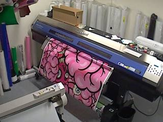

-I love takeups. I load wraps at night and run prints via my iPhone from home. Twice work as hiring someone. Been doing it for Years with no issues. Just watch it via security camera as needed.
(Yes! I know my printer is covered in cr@p in the pic) lol
