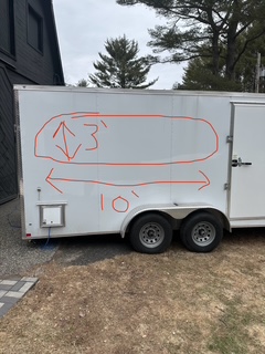

I mainly do die cut stickers and labels. Some larger stickers but I've never done anything this large for a trailer before.
It's a bit out of my comfort zone, but I'd really like to get experience doing more car graphic work.
What things should I watch out for when doing trailers like this? I have no tools to install and not sure if the customer was going to do it themselves or have me do it.
What would be some best practices for basic applications and getting graphics ready for installs on this?

When lettering a trailer like that you have to decide how to deal with the rows of screws. When doing cut vinyl or print and cut vinyl, our preference is to remove the screws where the vinyl will go, install the graphic, then reinstall the screws. The screws use a #2 square bit. They are very easy to strip out, so make sure your bit is not worn and be very careful to fully insert the bit into the screw head, maintain firm pressure, and use very judicious pressure on the trigger of your impact so you don't turn too fast and jump out of the square.
You're going to need a lot better pictures of the trailer than that to design for a pain-free installation. Square up the camera to the trailer. No angled photos.

That trailer looks like a rivetless body from quick glance. Make sure you have a good squeegee on hand if your graphics are going to be "premasked" or covered with a release liner, if not, the you'll need a nice soft felt squeegee so you don't scratch the graphics when applying. We do trailers all the time, from rivetless to skins with rivots or screws. screws you can take out, but the rivots you have to lay the vinyl over, having a good air release aids in application, but if you don't have that then just be diligent around the rivots if any. Image One Impact has all sorts of goodies and tools for installation. A good squeegee, blue grease pencil, some masking tape and a good tape measure are pretty much the basic tools required for installation. For graphic designing, you will want full measurements of each side that you are putting graphics on, with as straight on photos as possible. Good luck!
I think I may do a mix of both really. They want letter but they also want a graphic. I plan on going to see the trailer so I can get better pics and measurements on the trailer.

You can do multiple lines of tape, just try to keep the overlaps thin as possible. Smooth wall trailers like this are easy to do. Just remove the screws where the decals are going. Use the hinge method for installing (masking tape down the center, peel and squeegee half of the decal at a time) Then slice the decal down the seams of the trailer after they are applied, then put the screws back in.

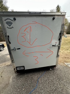

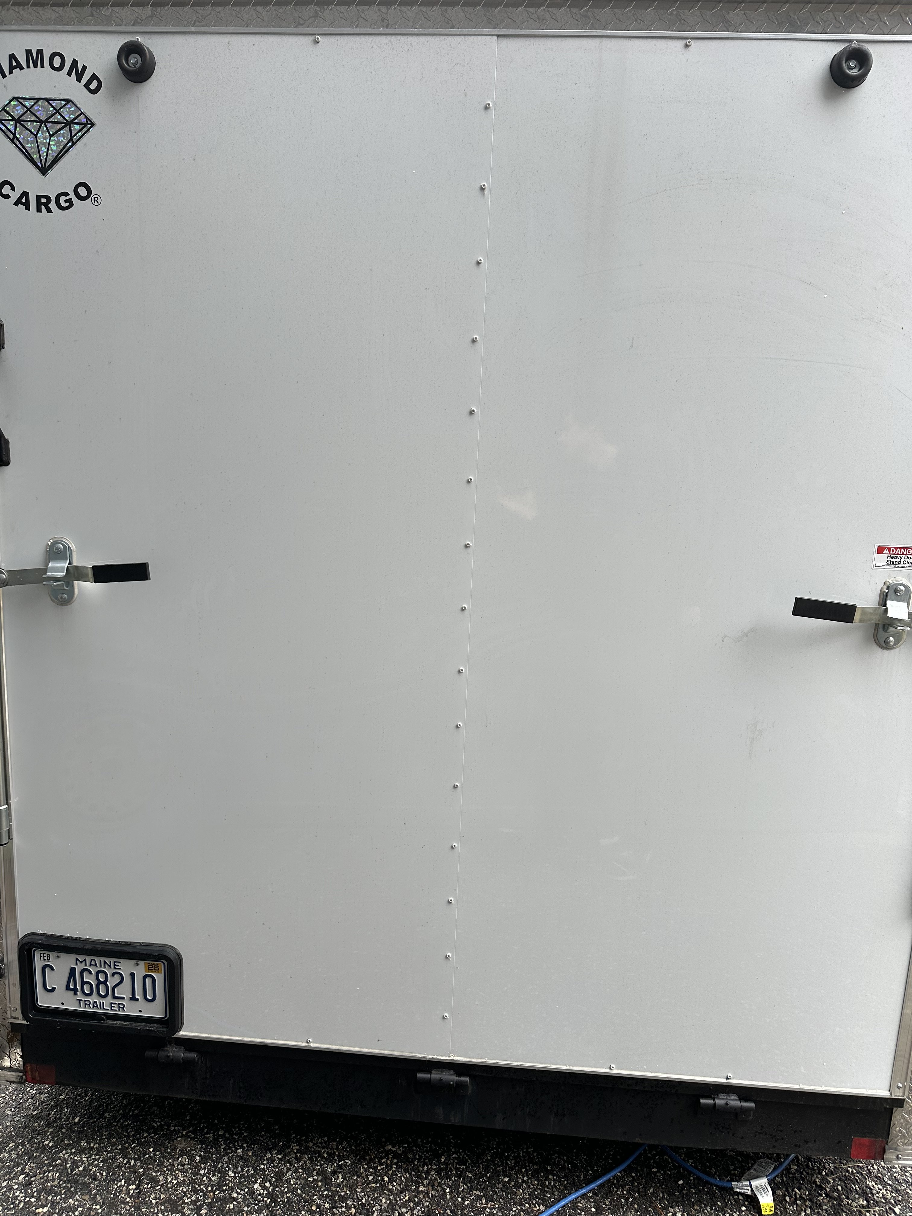

I was thinking they wanted some 4 color graphics but they just want cut vinyl. I have Orcal 651, would that be good enough for a trailer or should I look into some 751?
Here's what I'm doing for the back. Size is 35" x 26.5 right now. Thinking it'll be 3 pieces.
Any tricks on getting things aligned correctly? I saw someone put a couple of squares on each piece to match up to for alignment when they tacked up the vinyl.
Trailer definitely has screws in it with that star head it appears. I'm assuming taking some of these screws out might be necessary.
751 is cast and that's what should be used over the 651
Yes - make some squares to match things up for alignment then just remove when you are done. OR you can dry apply the first layer then wet apply the second and third layer, you can also get clear masking.
Yes - remove the screws just where the decal is going. Your decal is pretty small. If you had multiple large decals then I would say just remove the screws piece by piece.

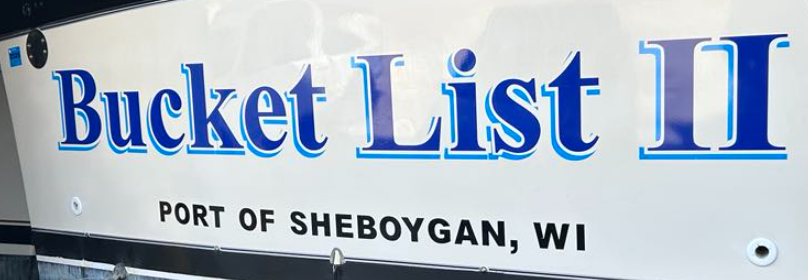

Stacey K
I like making signs
This one I did last week. I dry applied the dark blue then wet the crap out of the boat and the light blue (masked with clear) and then just slid the light blue until it was in place. I eyeballed it. You can always message any of us the graphics for advice if you don't feel comfortable posting them.
