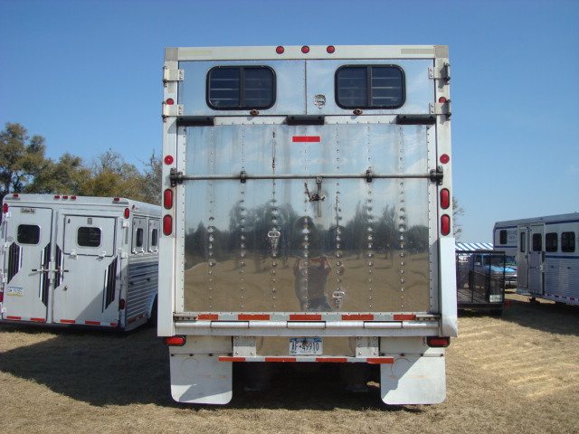

I am doing a trailer with rivets every foot or so in double rows..the stripe is 22" wide band all the way around. My method so far is align, squeegee, leaving tunnel for rivets...and rollepro. the vinyl seems to tack top/and or bottom closing off teh escape. Any other ideas on attack? tHANKS

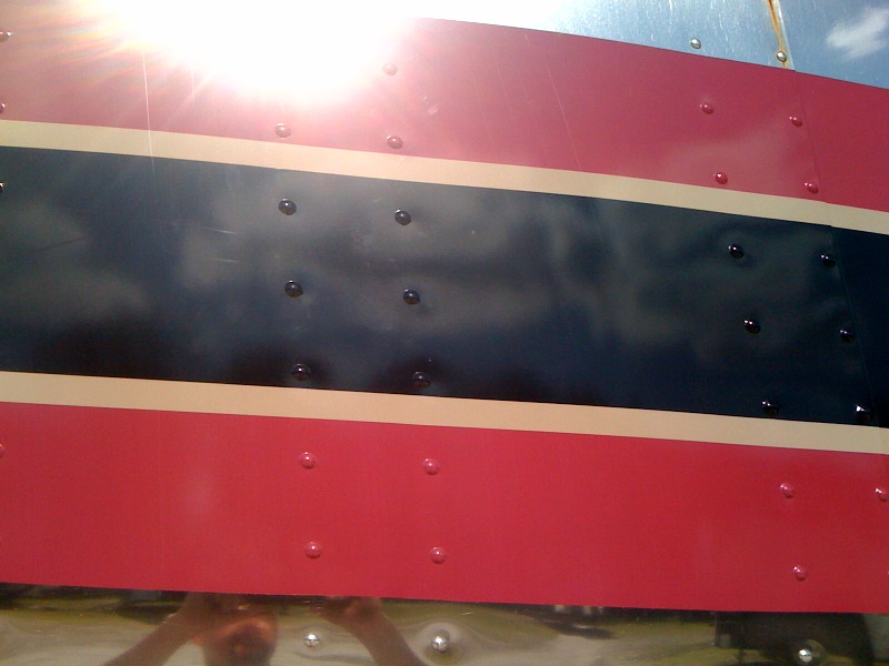

yepp..absolutely. the only thing was I used 3551/293 and wasn't impressed with the conformability on the rivets..

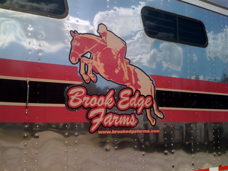

Why not use 3551/293? It is used to do wraps..right?
