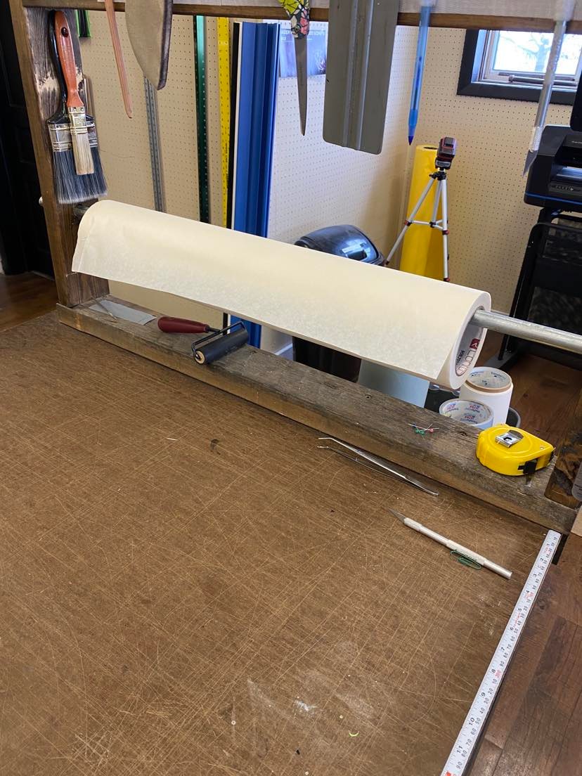

We have a very similar unit to this one that we got from Grimco years ago.
gnubler
Mine is like Stacey's, I acquired it from another sign shop. Wood frame, two holes with a metal pipe inserted. I clamp mine to the table with u-clamps so I can take it off as needed.

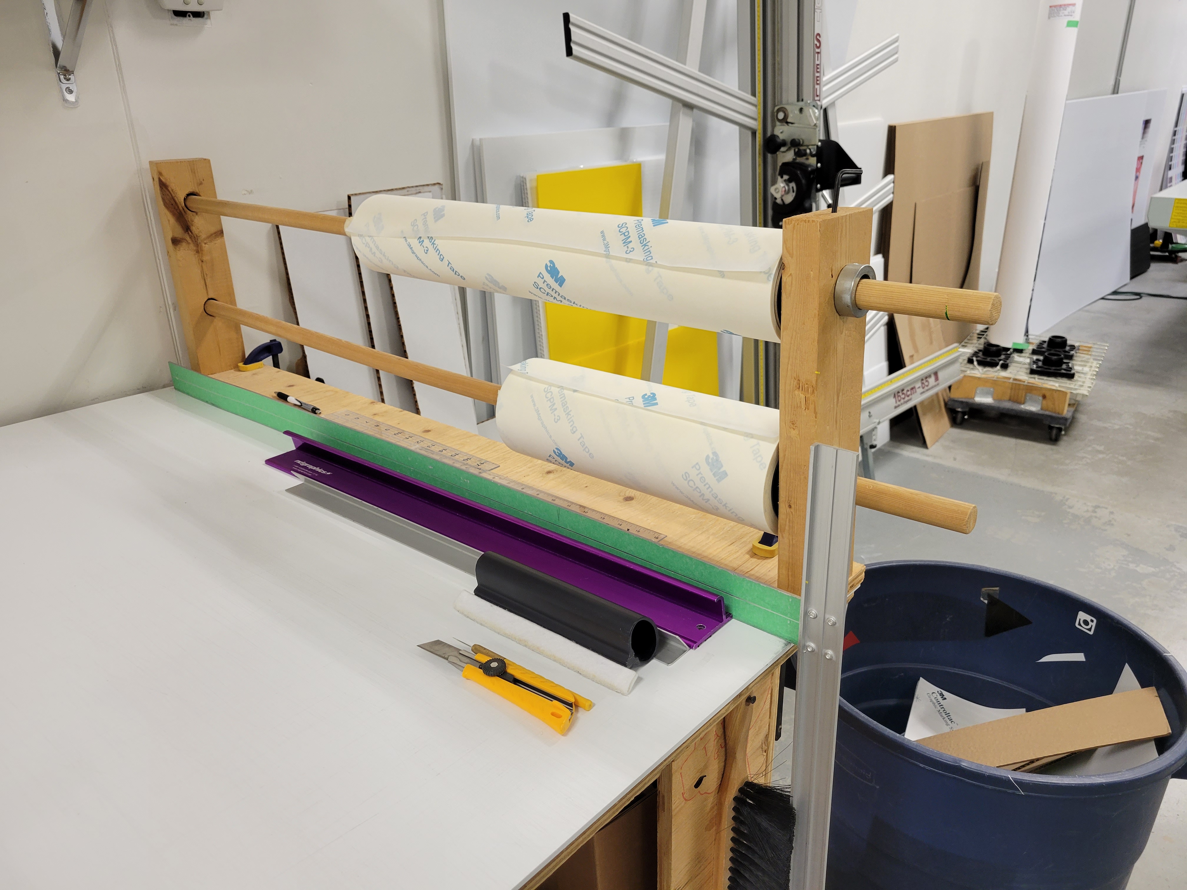

Ours is very similar but we use 3" to 1" plugs so that the rolls don't wobble around when pulling mask off.
I'll see if I can get a pick when I'm back down in shop.

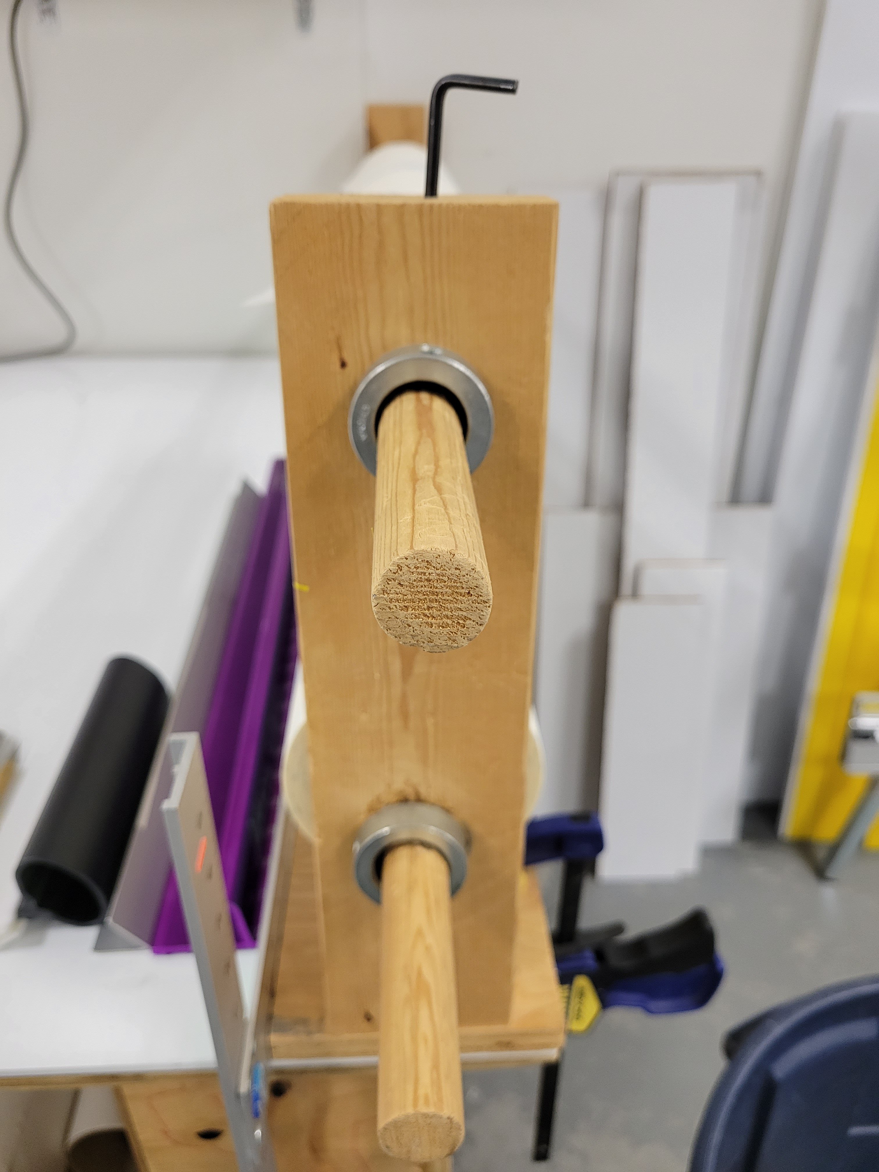

Here you go........not pretty but it works. Pretty sure we just used 1" dowels. I'm not even sure what the little tightening part is called but we have those on the ends so you can swap out rolls.
I can take a better pic of that part if you guys want it. I think we get the 3" to 1" plugs in our newsprint rolls that we buy for packaging etc.
Hope that helps!
