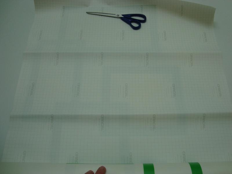

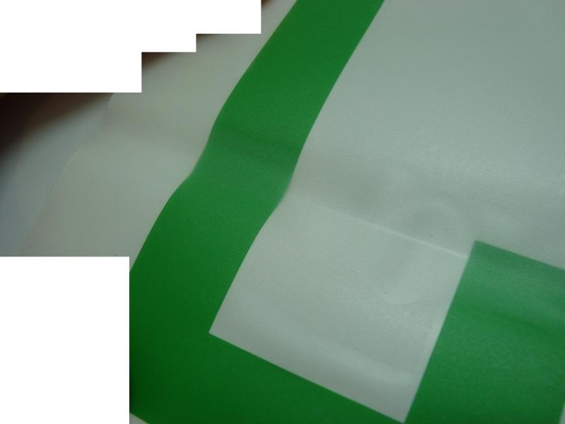

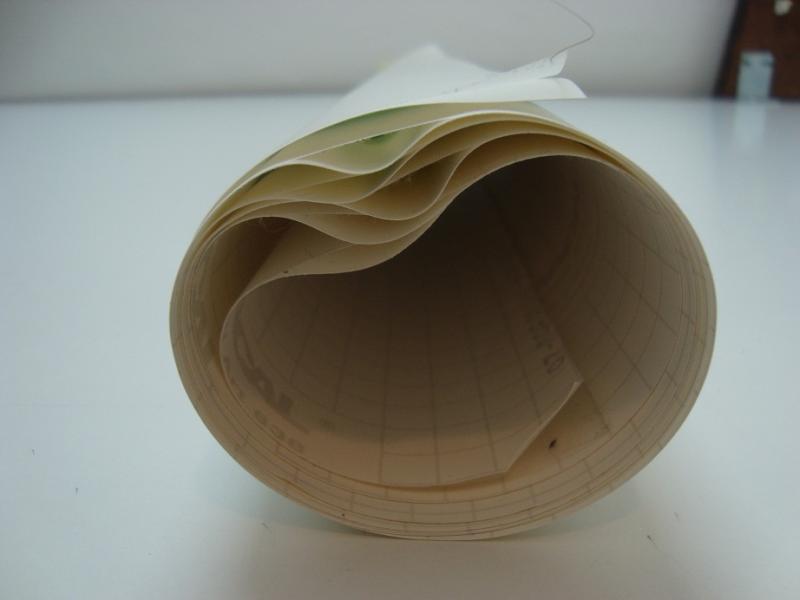

I realy need help with transfer tape. I dont know why but some times after application tape is on vinyl and roll in roll (for shipping like in picture) it get bubbles. But this bubbles are very big like the vinyl is crushed. It look like that aplication tape is shrink. I attached some pictures of this decal. This decal is extreme case, usually I get less bubbles.

I use oracal aplication tape Oracal LT95 and vinyl Oracal 638(wall art).
I thing the problem is in hand applying of transfer tape. I dont have laminator. I was thinking to make it on my ovn, but I cant find no info on web how to build it.

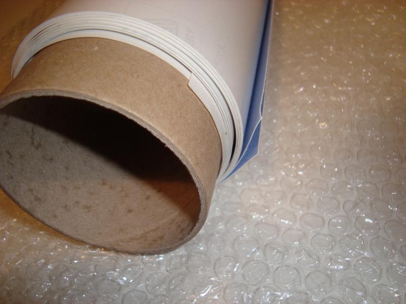

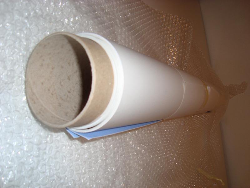

After you apply the transfer tape, wrap it around a solid tube prior to shipping. It will eliminate the wrinkles (and the installer will thank you).

@Moze.....Did you mean like this?

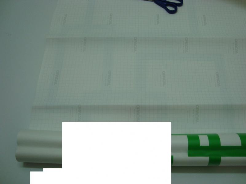

Sometimes I get this wrinkles when I start to wrap decal, in this case I smooth it from back side of the linear, but sometimes the wrinkles come back but not every time.
Any other suggestions about this? Like home made laminator?

Moze
Yes, precisely. If you ship it "loose", the transfer paper can start separating and can cause all kinds of headaches for the installer.
