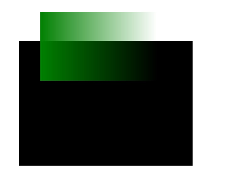

Inkscape does with no problem. Just like attached green gradient.
