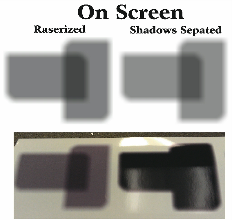

Here's a pic of the problem. These are on screen views and the resulting prints. First there is a pic of the vector image with the shadow still attached to them and one after I rasterize them into 1 image and the resulting prints below. The second is one of the shadows separated from the vector so that it is simply two bitmaps, and then the two bitmaps rasterized into one.
Weird.

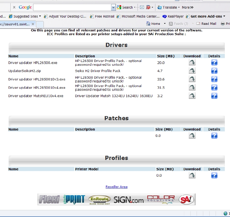

Here's what I get when I check for updates. Says no patches.
CS-SignSupply
Interesting.
The next option would be to download the full install file from here: www.flexisign10.com
After downloading, uninstall current version and delete the install directory.
Reboot and install newest downloaded version. I would also recommend installing the new version into a custom directory, i.e. C:/Program Files/SAi/SAi Production Suite 1051/

Seems like a lot of work, why won't it show in the updates?
CS-SignSupply
That I can not answer.... hence my 'interesting' comment.
This could only be answered by SAi, which I have contacted and am awaiting their response.
