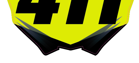

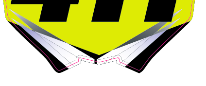

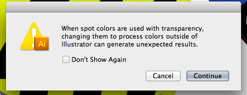

So I have some gradients and transparent pieces in the design, and if I export them as a .eps to print and cut on a roland, I get this error message about spot colors and transparencies. So I try to flatten the transparency and then it messes everything up. I've done this before, but now I can't get it to work again.... can anyone help me please? This is urgent

Rasterize the whole thing together (except your cutline) and it should print right.
Rasterize in PHOTOSHOP if Illy wont let you OR get rid of Spot colors and make all CMYK or RGB. That solves your transparency issue.

Once your rasterize, you can do a "Paste Behind" on your illustrator file, get rid of the other art giving you the headaches and drop the raster image directly behind your vector cut lines. Save normally and youre done. Let us know how it goes.

The spot color is coming from the spot color "CutContour" that you are saving the cut line in Illustrator as. You cannot have spot colors with transparency in most cases; used to have the same problem when I had a Roland.
Open the Illustrator file in Photoshop (without the contour line), rasterize it at a high enough resolution, place the rasterized version and the CutContour line into a new Illustrator document named "yourprojectname_flattened" and save that document to print from.
