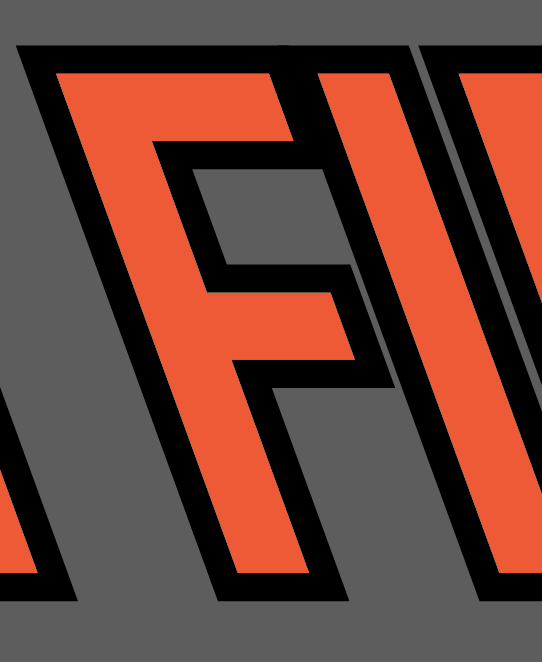

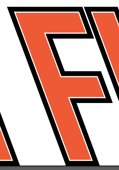

I am making some 2 color reflective lettering using Oracal 5600. It will be orange lettering with a black outline, pretty small (total size ~40in x 4 in). Should I trap the orange under the black outline (overlapping the edge of the orange with the black outline), or should I make a small gap between the orange and the black so they don't actually touch?
If making a trap of the orange under the black outline, what do you think would be the best, like 3/4 of the total width of the outline or just right in the middle?

I would do the outline first, all filled in rather than just the outline, and then center the orange on top. So there are no little lips, just a layer on top of a complete layer.

There are only a few reasons why you wouldn't do a full outline behind the top color.
  1. You're doing a translucent vinyl job in which you do like a 1/8" trap and lay colors accordingly.
  2. One of the materials has a much different life span. (i.e. a specialty florescent outline on regular black vinyl.) You'd do the same trap and overlay. If you did the florescent under the black, then you'd have to replace the black sooner than necessary. If that makes sense.
You're using the same amount of material either way. No need to over complicate it. Just do the full fill outline first and overlay with the second color.
I also don't know anything about doing installs onto aircraft specifically relating to layers of vinyl and all that. So maybe someone will chime in on that.
surferkai
I think I see what you're saying. I will go with that, and see how it turns out. Thanks, I appreciate your input and time!
